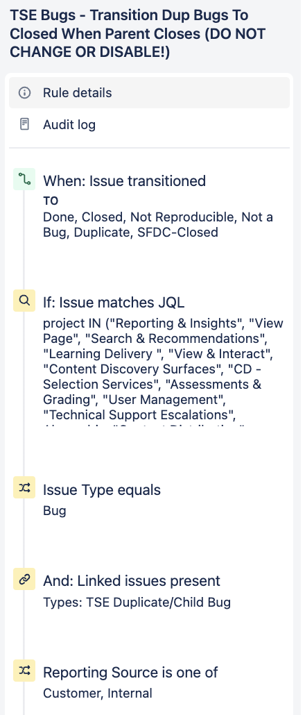

Because the automation rule starts at the top with the trigger which you cannot filter as far as I'm aware -- my trigger is when an issue transitions to particular statuses. The problem is: I only care about issues in certain projects and not across all of Jira. The trigger unfortunately looks at every project and every issue transitioning to my specified statuses. We have a LOT of projects and issues which means this automation rule runs all the time.
I have worked with Atlassian Support several times to figure out how to optimize this rule. It focuses on issues linked from a single project to another 13.
RULE

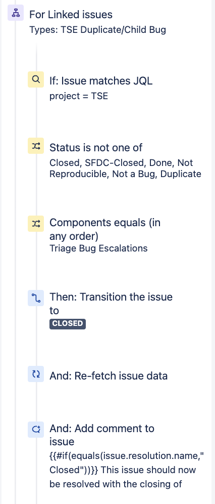

In a nutshell the rule is looking at:
- bug issues in Project A that are linked using a specific link type across another 13 projects. These are considered our parent/source/original issue.
- When these issues are found, we close Project A's child/duplicate issue
- We update Project A's resolution value to match the parent issue's resolution value
- We make custom comments based on the resolution value
