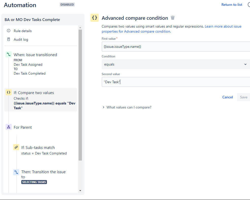

I have a rule to transition a parent issue when all the sub-tasks are completed. It works with one sub-task/Issue Type/workflow: {{issue.issueType.name}} equals "Dev Task".

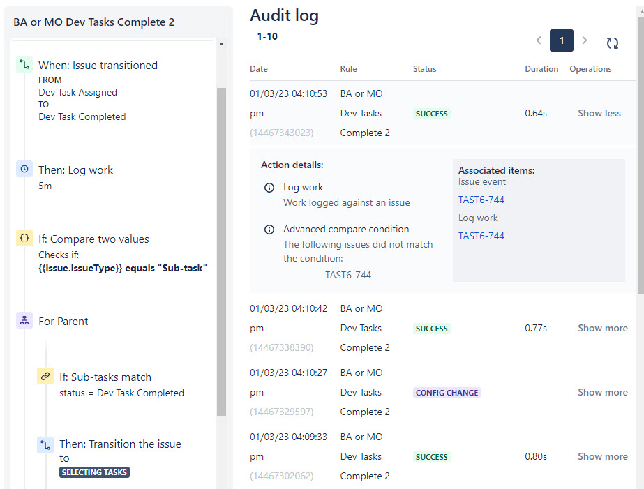

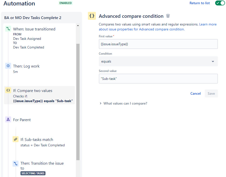

I changed the first Compare to {{issue.issueType}} and Sub-task, but it apparently isn't working. Since there are two issue types, if I go back to {{issue.issueType.name, I don't know whether or how the rule can be changed so that it looks at both.

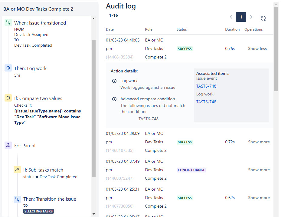

Then I changed the Compare to {{issue.issueType.name}} and "Dev Task" "Software Move Issue Type", but got the same result.
1) Original rule that worked when there was one sub-task issue type (one workflow):
2) New rule :
3) New rule log, showing success only because of comment written to log:
Note that the same Advanced compare condition that did not work appears for both sub-tasks, that use different Issue Types and workflows but share the same statuses. I also get the same result if I don't use quotes around 'Sub-task'.

3) Log for rule with {{issue.issueType.name}} and both issue type names:
