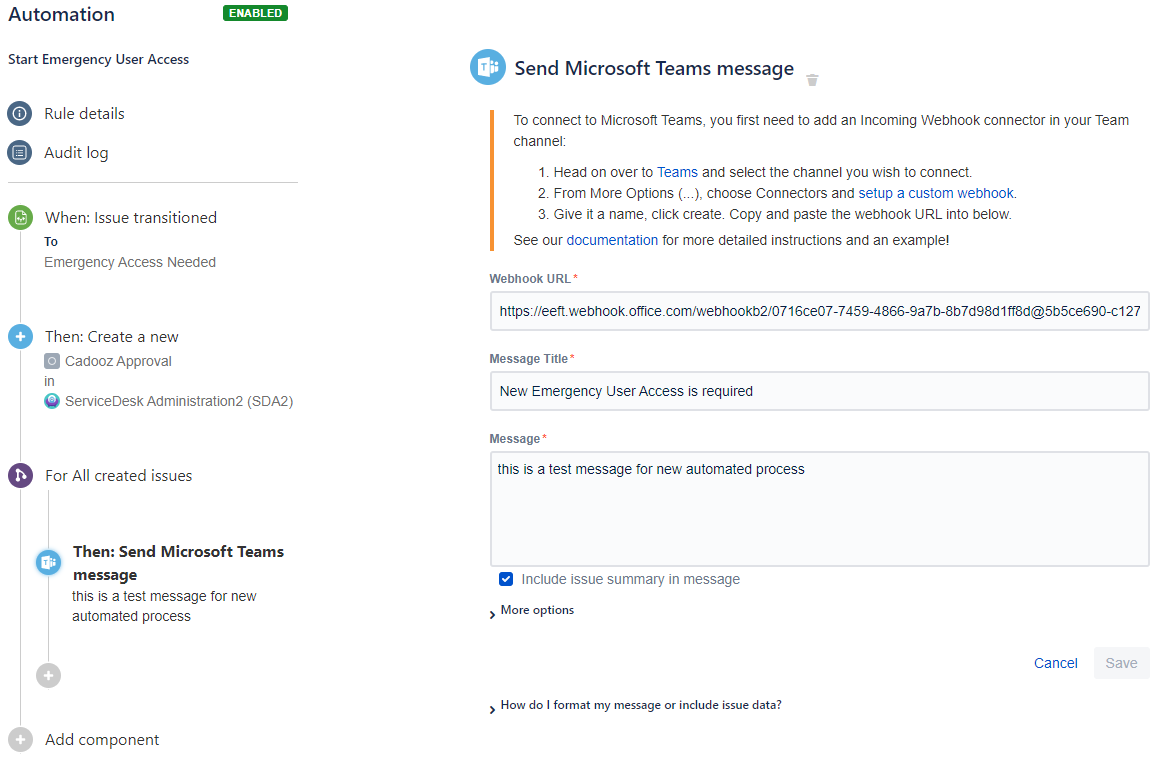

The first approach is through automation:

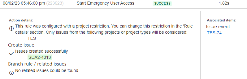

The triggers should start when the status is "Emergency Access Needed". I already tried including the webhook that I got from both JIRA Cloud or the Webhook in teams, but still no result. Though the Audit log, I can see that it does not recognize the new created ticket as issue:

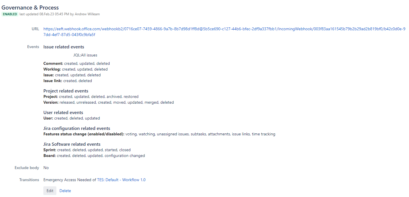

The second is through Post Function in transition:
so I created a new webhook in JIRA Admin System and includes it in the transition in workflow design.
I enabled all the options as i just want to test it out. And connect it with the designated transition.
