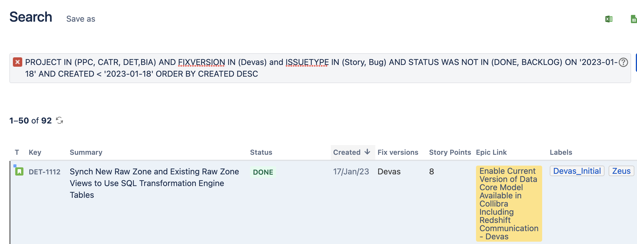

Query1: Not Done not in the Backlog
PROJECT IN (PPC, CATR, DET,BIA) AND FIXVERSION IN (Devas)
and ISSUETYPE IN (Story, Bug) AND STATUS WAS NOT IN (DONE, BACKLOG)
ON '2023-01-18' AND CREATED < '2023-01-18' ORDER BY CREATED DESC

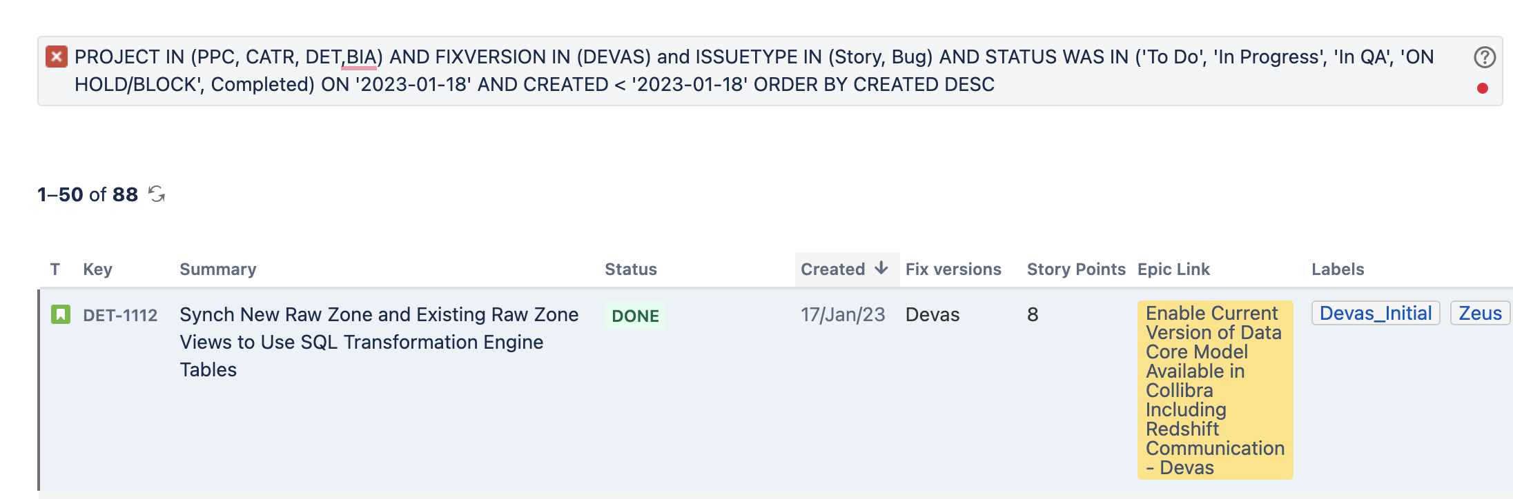

Query2: In valid status ready for the team to work
PROJECT IN (PPC, CATR, DET,BIA) AND FIXVERSION IN (DEVAS)
AND STATUS WAS IN ('To Do', 'In Progress', 'In QA', 'ON HOLD/BLOCK', Completed)
Here is the result for the Query1:
Here is the result for Query2:
As you can see the total count is not the same, but not just that, there are 10 issues in Query1 not in Query2 result and 6 issues in Query2 not in Query1 result.
