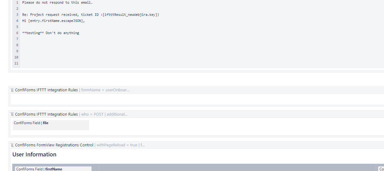

With form above I'm able to capture data, create JIRA ticket (not shown), and then create confiforms entry (first IFTTT) with jira key and attachment.

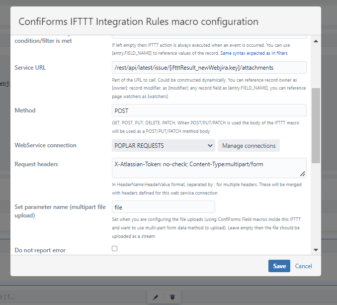

The second IFTTT form is to add attachment. I have tried various headers, with and without content, with and without 'Set parameter name' to file, and with different api path (/rest/api/latest/issue/... vs /rest/api/2/issue/...). Most errors are coming back 415.
