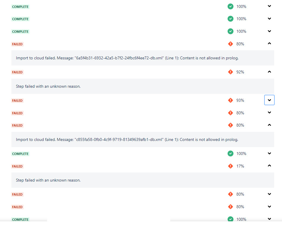

I'm currently testing the migration from Confluence Server to Cloud. We have around 50 Spaces. During the migration about 50% of the spaces fail with the message: "Import to cloud failed. Message: "<GUID>-db.xml" (Line 1): Content is not allowed in prolog."

As a bonus question: How do I find out what causes the "Step failed with an unknown reason"?
