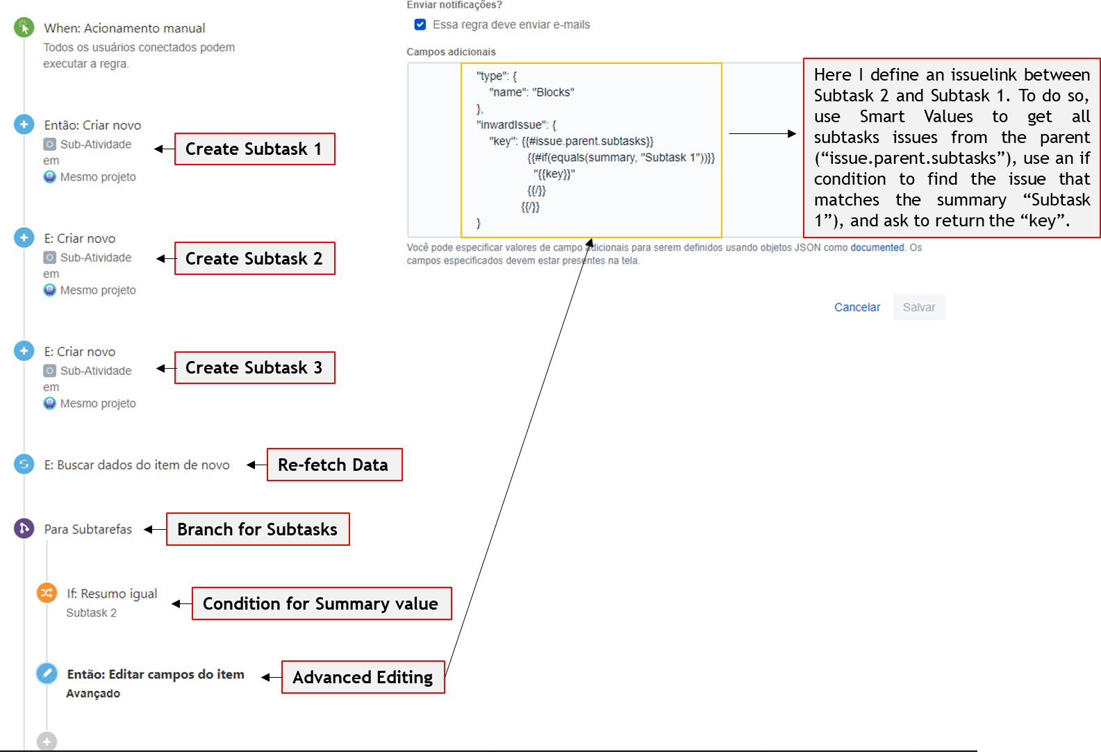

The main reason I need this is because I need to find specific child issues, by it's summary, so a can link it to another child issue. I was doing this using a Task and Subtask structure, and it worked, but now I have the need to do the same using Child and Parent relationship.
This is an example of how I've achieved it using Task and Subtask:
- So I pretty much need a substitute for "issue.parent.subtasks" when using a Child / Parent relationship (from the Parent Link field).
