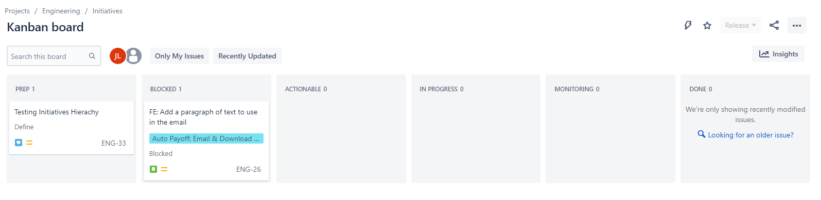

Here's the board view. When I created a test Initiative it showed up, but a test Epic did not. The current filter is just all tasks on this project.

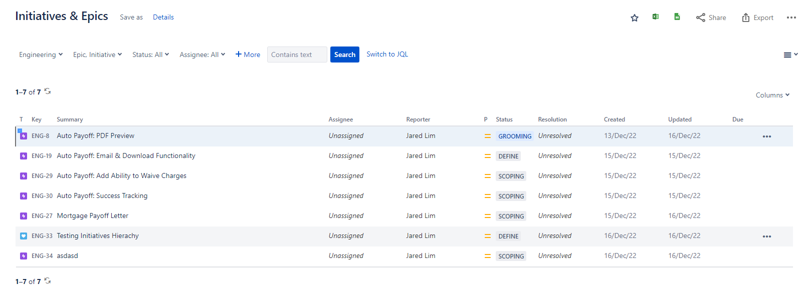

Here's the custom filter I'm using. You can see it's getting the Epics

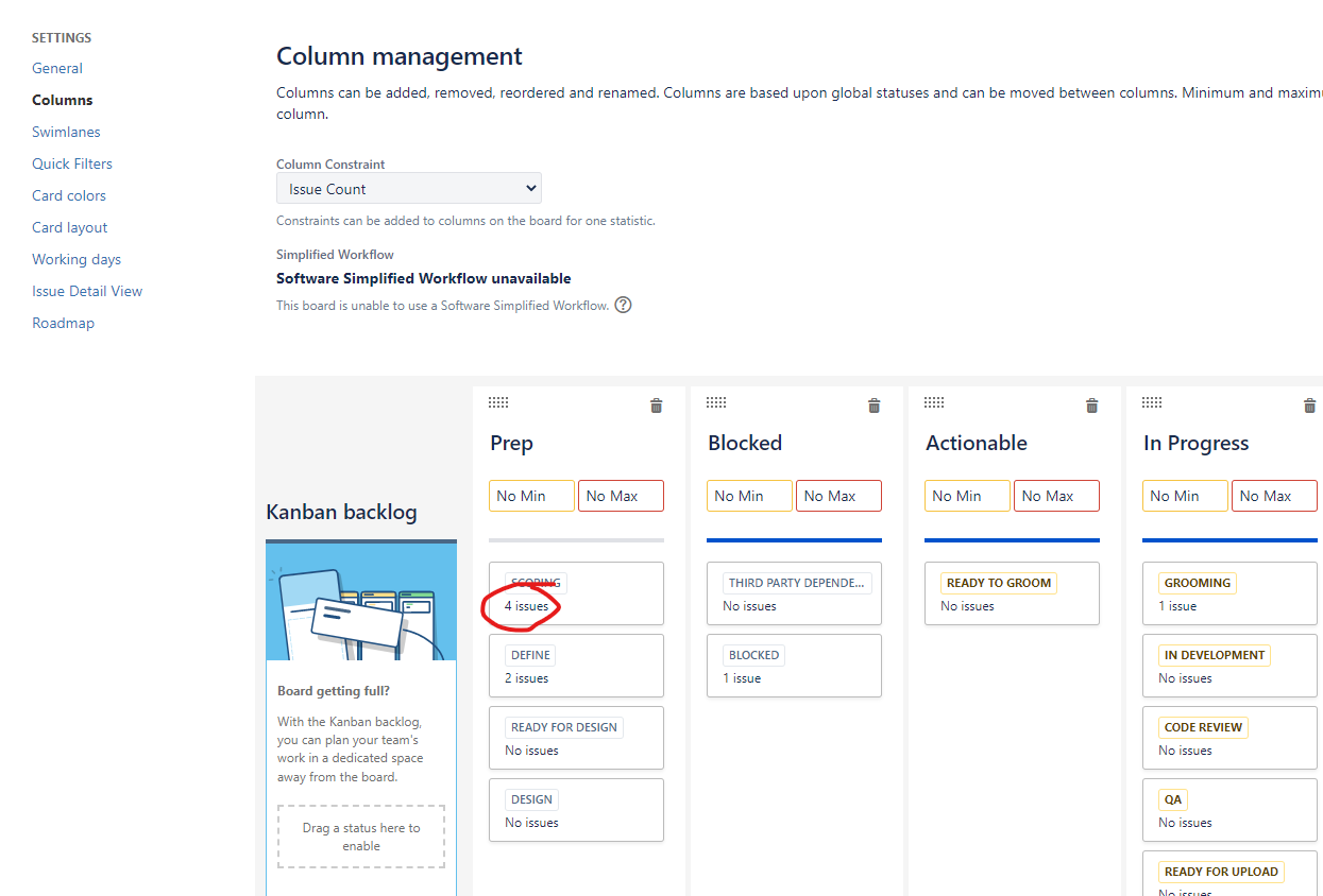

And here's the Board Settings, you can see that it knows there are multiple issues that should appear in Prep based on status (the Epics) but they are not displayed.
