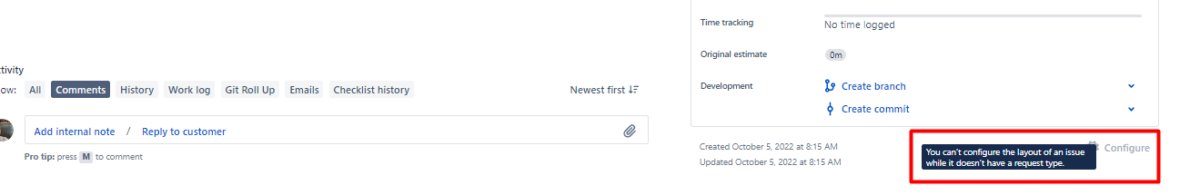

I have prepared a new JSM Project, for that i had defined several Custom Fields. Additional, i need the Sub-Task in cases of escalations. My Problem is, that i can't configure this Fields:

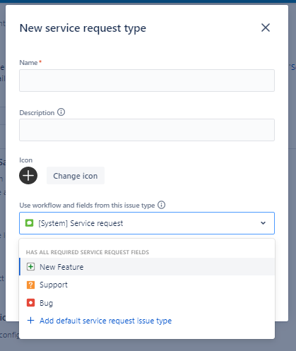

The Message tells to me, that i need a "Request Type". Ok, i had tried to create a New Request Type for Sub-Task, but that was not possible, i can't choose Sub-Task Issues for creating a new Request Type:
Ok, wrong path...

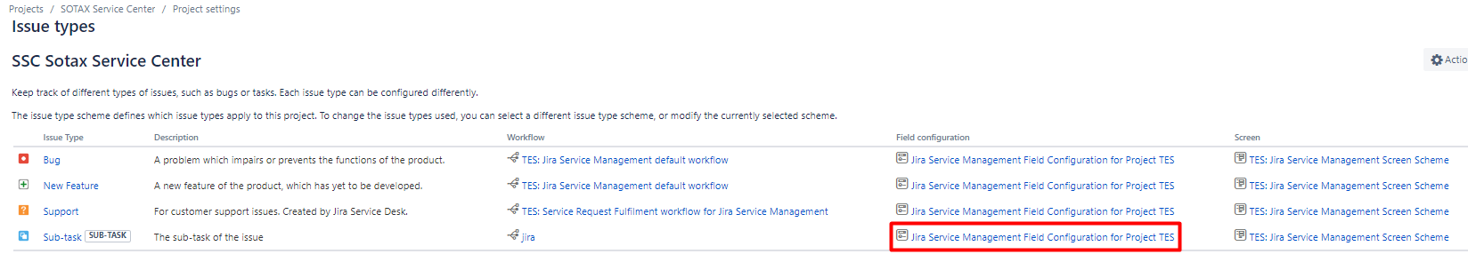

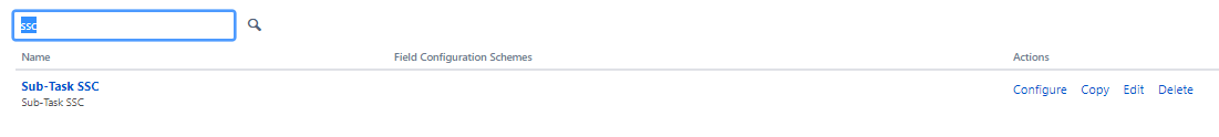

Ok, also the wrong path... i asume, that i need a different Field Configuration for the Sub-Task, so i have created a new one:
But, i can't assigne it to Sub-Task ussed in my JSM Project!...
