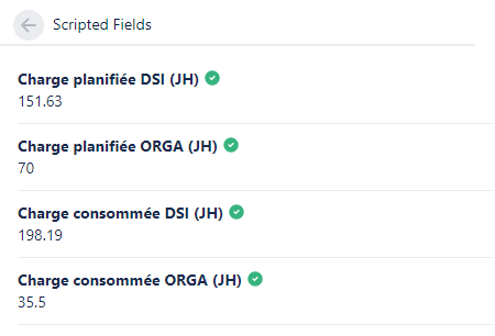

Hello Everyone,
Please i need to create (or modify the current script) a Scripted Fields to calculate the sum of Loads Planned and Consumed according to the users entity and NOT THE ACTIONS ENTITY.
Example :
If the users are from the ORGA entity and they timetrack in Tempo, the Scripted Fields must show me the sum of Loads Planned and Consumed according the users of ORGA entity. (the same for DSI entity)
Please find below the script currently used :

You can download the script in a txt file from here : Scripted Fields.txt
Best Regards,
Thank You.
