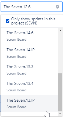

Hi community! Question for you guys. We are using JIRA Align together with JIRA Cloud - we practice SAFe and have pre-populated JA with sprints for the next two PIs. An issue that our teams are facing is that when they go into a story to assign it to a sprint, the list of available sprints go so far out - even if you filter for only the sprints in that particular project it truncates at ten and sorts descending so you have to manually type in the team name + sprint to find the one you want (which is most often the next or current sprint).
In the screenshot attached for example, we are currently executing on PI 12 but when team members go to assign a story to a 12.X sprint, they can't even see PI 12 sprints b/c they are buried beneath future sprints. Does anyone know of a way to apply better sorting and/or allow the list to scroll indefinitely (it currently truncates at 10 in descending order)?
