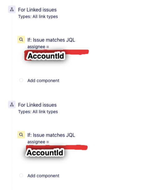

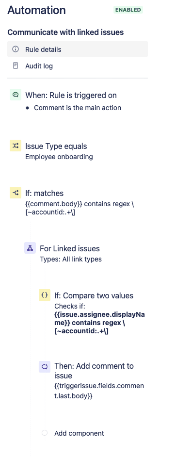

I got asked a question if it was possible to communicate from (in this case) the HR issue to the IT issue based on the accountId. Note that HR won't able to access the IT project. So what I thought is that when the "@mention" is used in a comment in the Employee onboarding issue type, copy the comment to the linked issue if it matches the accountId for the assignee on that linked issue. But I'm not really finding a way to do that right now.
What I have made up until now is this:
I also tried it another way for the linked issues, this works but I want the @mention to work with the accountId of the assignee, because a employee onboarding has different tasks and I don't want that when someone from HR says: "@Damian is this almost finished?", that someone in a different linked issue also sees this. This is the way that works but also copies the comment to all the other linked issues if the assignee = "accountId":
