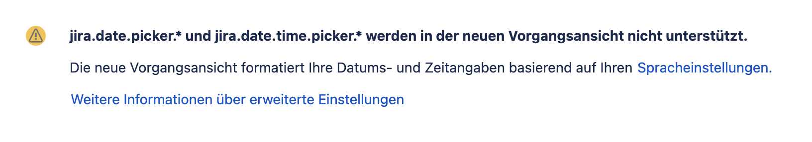

But the configuration is not possible in Jira Cloud when i open the extended settings:
(it's in german but it says that the solution from the KB article posted above is no longer working with the new issue view as the date format is based on the users language settings)
