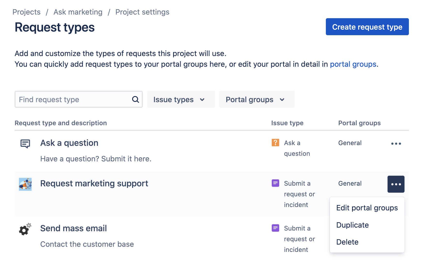

To use the feature, click on "Project Settings" > "Request types" and then select the ellipsis menu (see below).

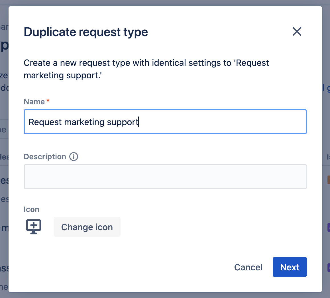

You will then be prompted to rename the request type, update the description and select an appropriate icon.

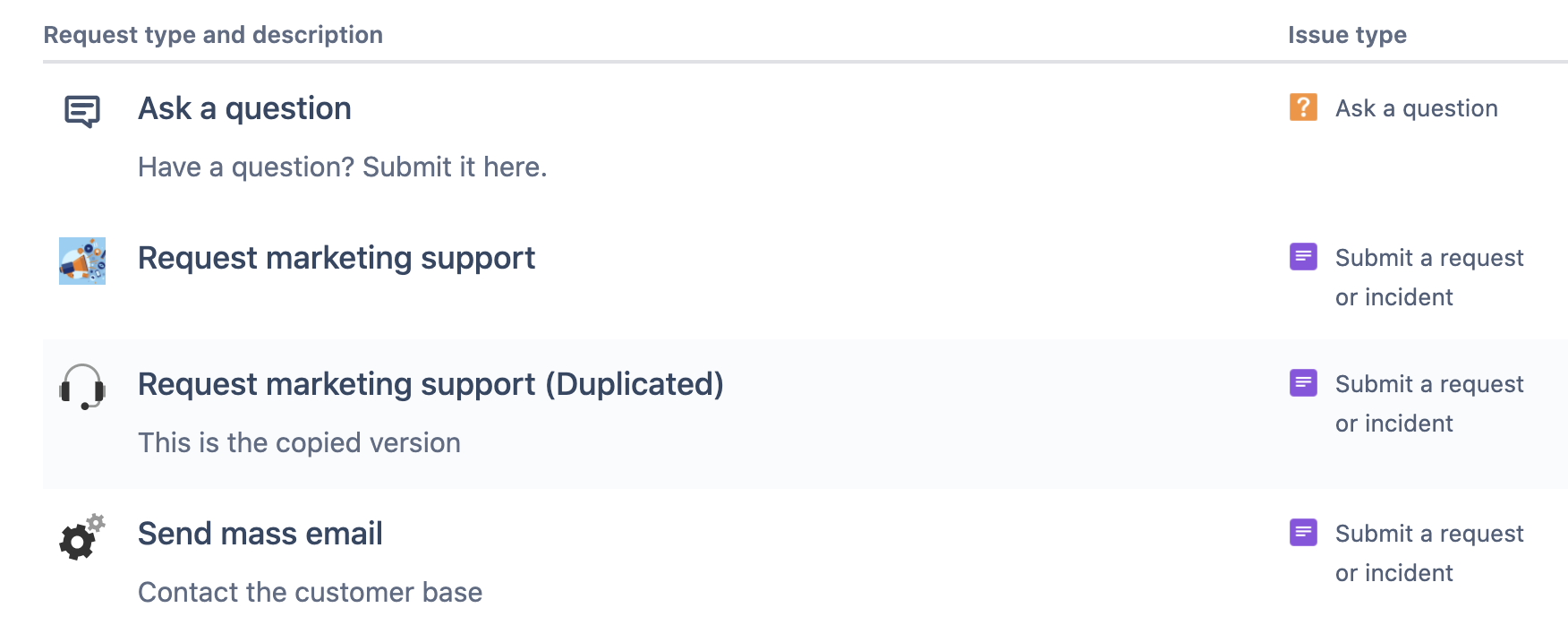

Once created, your new request type will contain the same configuration as your original request type.
While this does copy the vast majority of the request type configuration, it does not copy any associated forms and any JQL set to the Request Type level will need to be updated.
