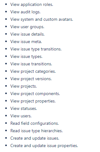

I enabled the read:issue.transition:jira in developer console and also added this scope in code. But that particular api is missing inn the error message.

Below image has list of scopes that I enabled
