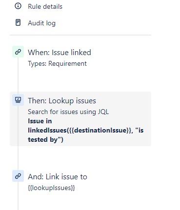

Recently, one of our critical automations has stopped working.
We have the custom issue link types "Requirement" and "Test" in our instance. We have dedicated issues for our requirements, development tasks and test cases. They exist in separate projects. We link our requirements and test cases as part of our planning.
When a development task is described, we link it to the requirement issues. At this point, our automation used to link relevant test cases to the development task. We had the following rules in the automation:
Normally, when the development task is linked to the requirement, the issue is triggered. Then the lookup linkedIssues({{destinationIssue}}, "is tested by" finds all test cases attached to the requirement. In the final step, test cases are linked to the development task. Until Jan 11, 2022 everything was working fine. However, now the audit log shows that the 2nd step with the lookup issues returns no issues. Is {{destinationIssue}} smart value no longer supported?
