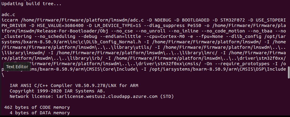

I've got a custom docker image set up with all the required configurations, and a .yml file to load the docker image, and run the iarbuild command. Where I'm getting stuck is that while I can successfully build in my docker container locally, if I try running the same command in bitbucket my build hangs forever until I kill it.
Can anybody think of a reason why a script would work successfully in a local docker container but not on bitbucket's environment? I'm rather stumped.
See the output from bitbucket pipeline. It almost seems like the command is missing a return key or is waiting on something to continue. I've uploaded a screenshot of what happens when I run the same command on my local docker container.

<span>adc.c </span>
<span>iccarm /opt/atlassian/pipelines/agent/build/Firmware/platform/lmswdm/adc.c -D NDEBUG -D BOOTLOADED -D STM32F072 -D USE_STDPERIPH_DRIVER -D HSE_VALUE=3686400 -D LM_DEVICE_TYPE=15 --diag_suppress Pe550 -o /opt/atlassian/pipelines/agent/build/Firmware/platform/lmswdm/Release-For-Bootloader/Obj --no_cse --no_unroll --no_inline --no_code_motion --no_tbaa --no_clustering --no_scheduling --debug --endian=little --cpu=Cortex-M0 -e --fpu=None --dlib_config /opt/iarsystems/bxarm-8.50.9/arm\inc\c\DLib_Config_Normal.h -I /opt/atlassian/pipelines/agent/build/Firmware/platform/lmswdm/ -I /opt/atlassian/pipelines/agent/build/Firmware/platform/lmswdm\..\..\library\utils/ -I /opt/atlassian/pipelines/agent/build/Firmware/platform/lmswdm\..\..\library\lmswdm/ -I /opt/atlassian/pipelines/agent/build/Firmware/platform/lmswdm\..\..\library\lmrc/ -I /opt/atlassian/pipelines/agent/build/Firmware/platform/lmswdm\..\..\library\irb/ -I /opt/atlassian/pipelines/agent/build/Firmware/platform/lmswdm\..\..\driver\stm32f0xx/ -I /opt/atlassian/pipelines/agent/build/Firmware/platform/lmswdm\..\..\driver\stm32f0xx\cmsis/ -On --require_prototypes -I /opt/iarsystems/bxarm-8.50.9/arm\CMSIS\Core\Include\ -I /opt/iarsystems/bxarm-8.50.9/arm\CMSIS\DSP\Include\</span>
