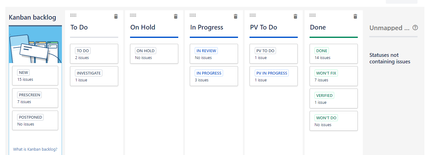

When I create a Story type issue, this one doesn't show anywhere except from the left side Issues menu. Creating a bug or any other issue type works well i.e. they show up in the backlog as expected.
This is the filter for the board that I am using:
project = GCT ORDER BY Rank DESC
I also have this sub filter: fixVersion in unreleasedVersions() OR fixVersion is EMPTY
Changing the status of the issue doesn't help.
All the different statuses are correctly mapped to column in the board settings.
PV To Do is grey & this is intent, this status is also used in a different QA Kanban board. This PV To DO state is a different one from status To Do:
