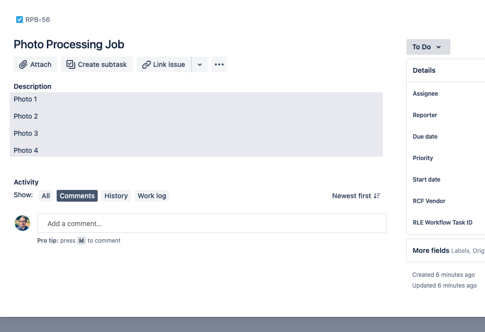

However, instead, I am seeing the following behavior.
- The text appears in the issue as described, but no URL linking is available.

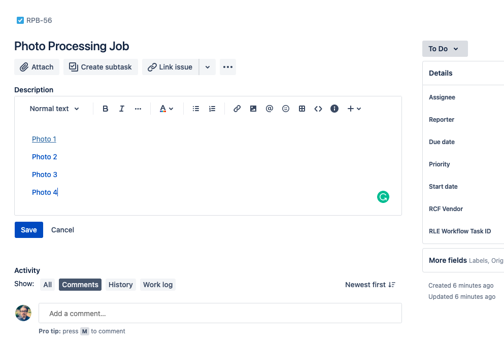

- Once you edit the issue, the URL linking to the text becomes available.

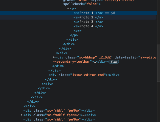

Furthermore, I have found that even when editing the issue, the links are not really there.
See the screenshots below...
Please help. I don't know if I am just doing something wrong or if this is some sort of a bug. I am sure it is more likely that I am just missing something.
