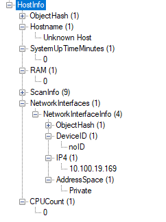

However, when I look at the scan result file, I do not see this information:
After talking with Atlassian, they instructed me to use the SNMP Extended Values list scanning method to scan for these additional attributes. I may be incorrect in my understanding but as long as I am using SNMP_GET or SNMP_WALK to scan for attributes that already exist in the DeviceInfo-Object, like Serialnumber, Hostname, Model, and Vendor, I shouldn't have to use an ExtendedInformation list to map to object attributes. Looking in the ObjectHashSettings.xml document, that should be the following attributes.

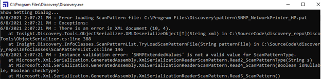

Please let me know if I am thinking of this incorrectly. I did try using the example SNMP Extended Values Scan type using the provided example in the documentation but when I try to execute it, I get the following error.
Original Pattern File:
