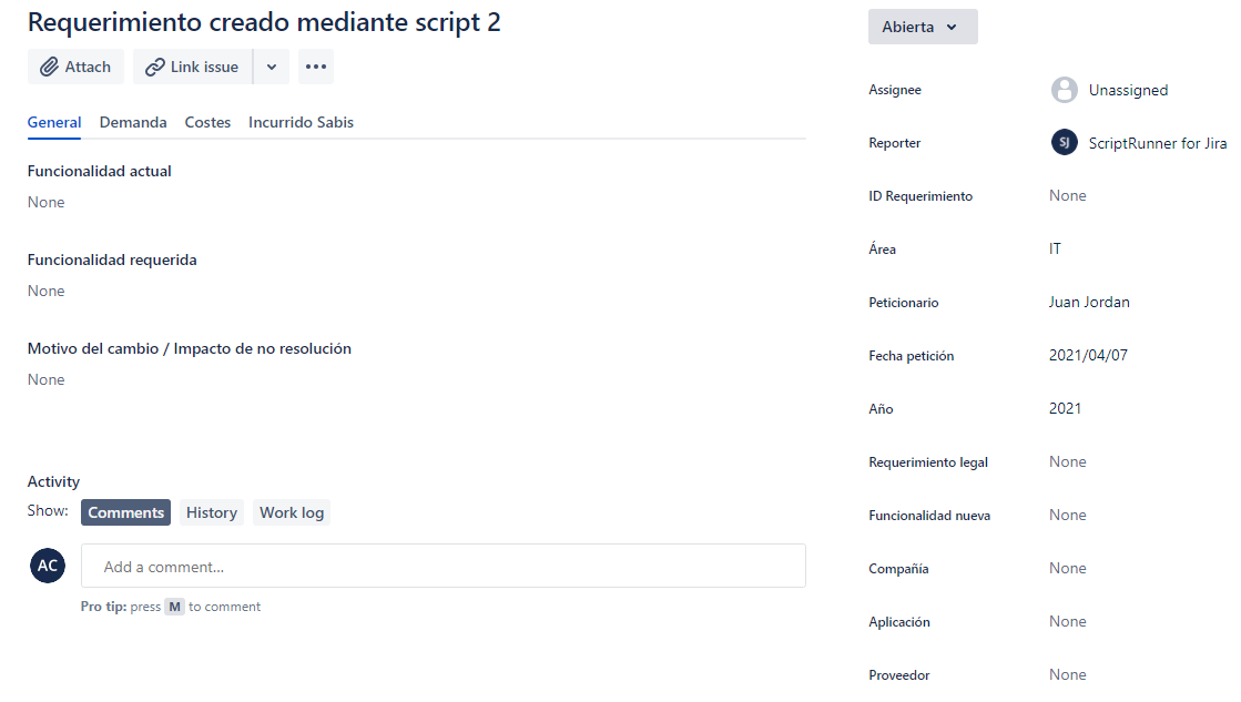

Hi, I'm trying to create a new issue and I have to inform the mandatory customfields. When I try to infrom the multiselect custome field appear this error message:
{errorMessages=[], errors={Compañía=Specify the value for Compañía in an array}In the next link (Jira REST API examples (atlassian.com) I found that the correct form to inform a multiselect field is "customfield_10008": [ {"value": "red" }, {"value": "blue" }, {"value": "green" }] but when I try the error message disapear and create the new issue but the customfield is without value. My multiselect field are Compañía, Aplicacion and Proveedor.
I don´t know how is the correct form to inform this type of fields.
Thanks!
The part of the code that I use to create a issue is:
