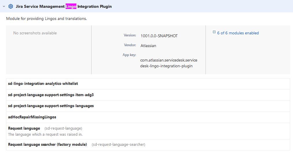

I'm running into an error relating to a Jira Service Management Lingo Integration plugin. On Jira Cloud, the plugin exists but it's not imported to my temp instance.
This is the plugin on Cloud:
