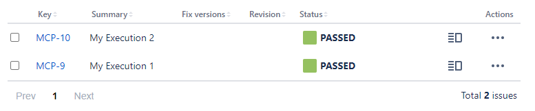

I created a personal workspace on atlassian, added the Xray add-on, and I made a project(MCP) where I added a Test issue (MCP-8) and two Test Executions which include this Test (MCP-9 and MCP-10).
I performed a GET request on the following link in order to get information about the Test issue: https://<my-host-name>.atlassian.net/rest/api/2/issue/MCP-8 . Since there are the two Test Execution linked to this Test, I was expecting to find the Test Executions mentioned in the received JSON.
Do you have any idea how could I get the Test Executions related to a Test, either via REST or maybe JQL query?
