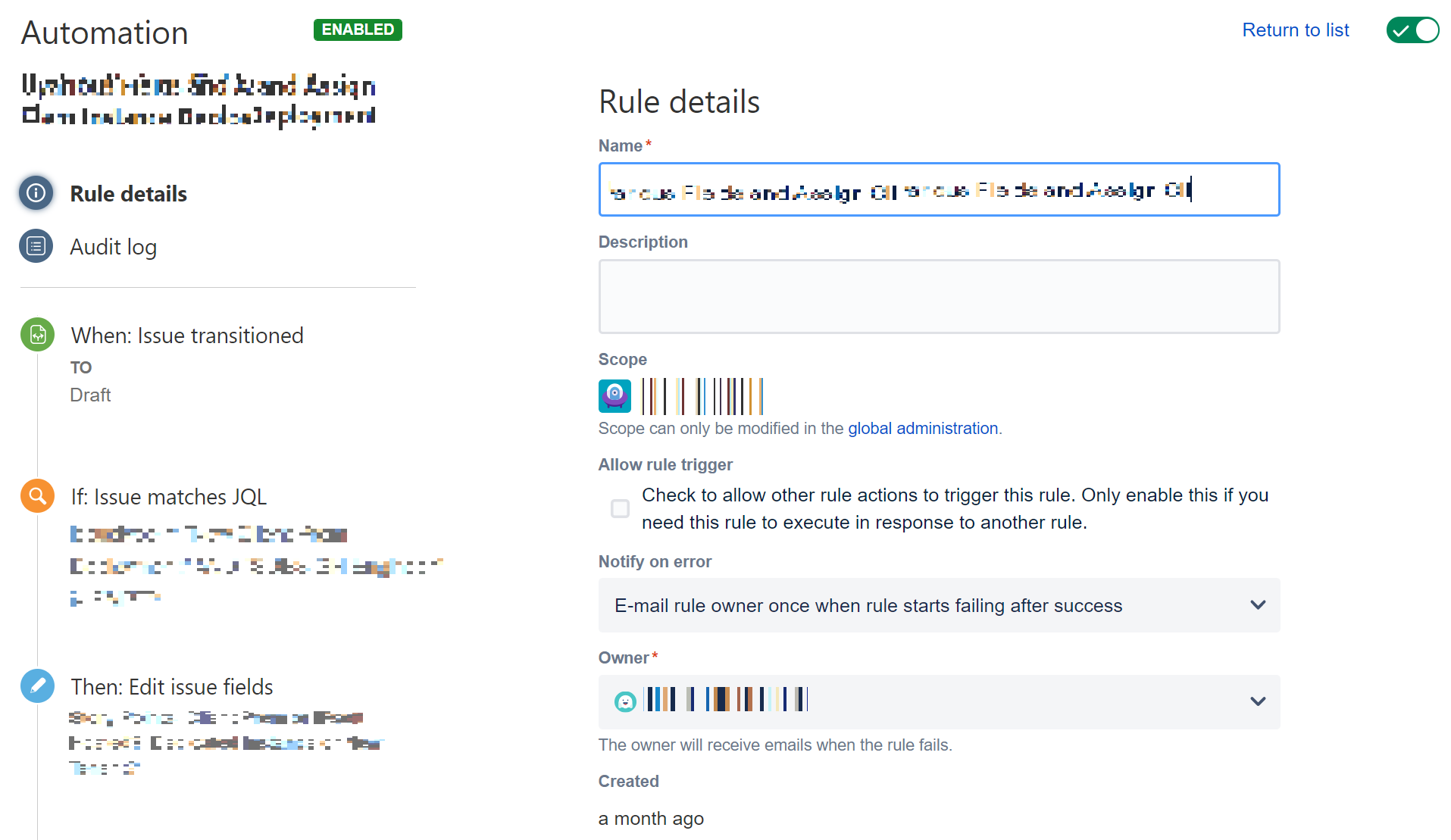

Here is the situation... I have a project automation for which the trigger is "When: Issue transitioned to DRAFT"

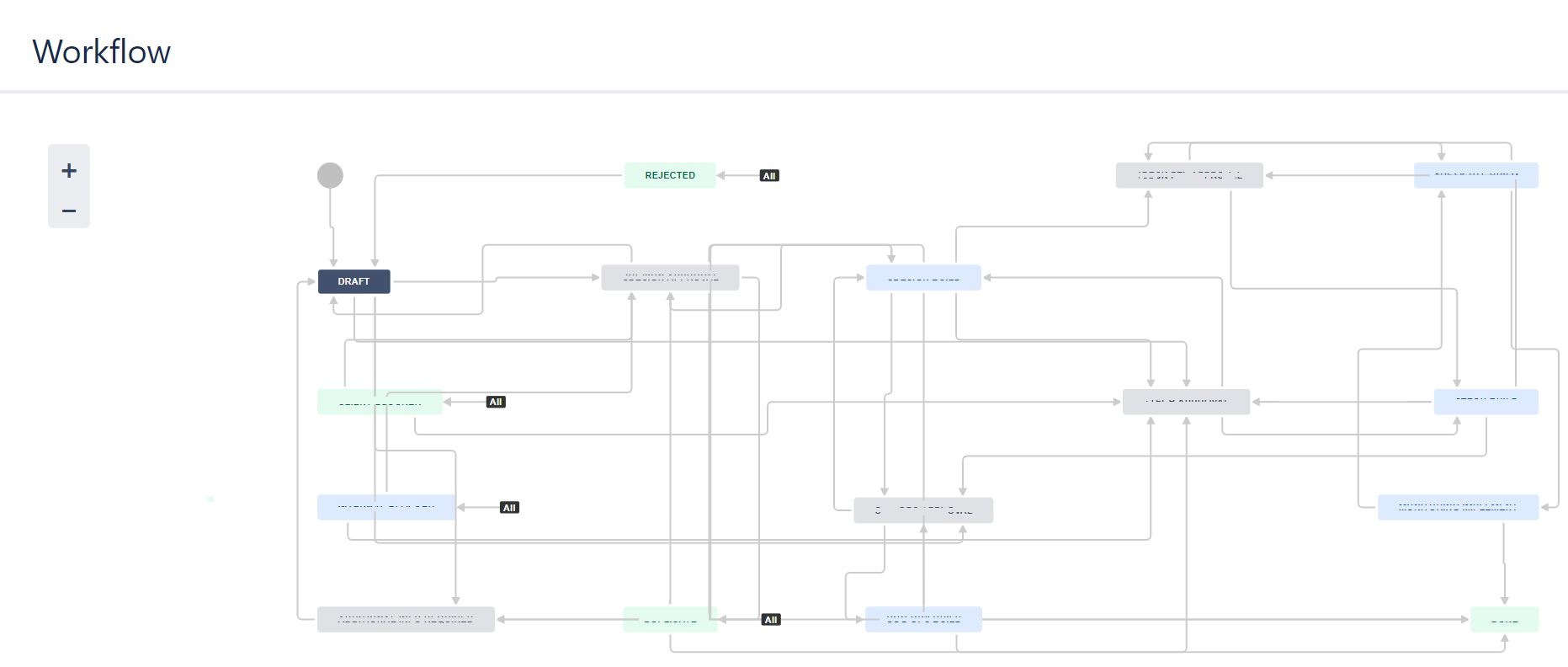

As you can see in my workflow, DRAFT is the initial status.
I expected this automation would be triggered both when the ticket is created and also whenever the ticket is transitioned from any other status into DRAFT. However, it seems this automation is NOT being triggered upon ticket creation.

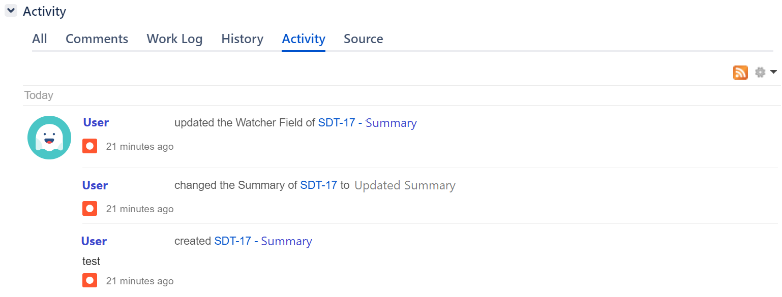

- For the ticket with ID SDT-17, I created the ticket and it was moved to the initial state in my workflow, DRAFT.
- However, the activity log does not show it was actually transitioned to DRAFT.

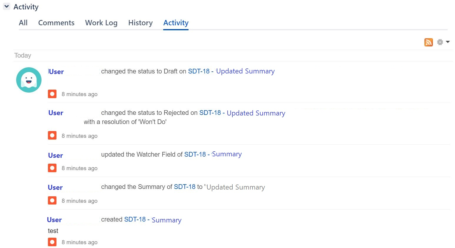

- For the ticket with ID SDT-18, I created the ticket (it was also moved to the initial state in my workflow), then I manually moved it to REJECTED and back to DRAFT.
- The activity log reflects this.
Once I moved SDT-18 from REJECTED to DRAFT, my automation was triggered and executed as I expected.
For SDT-17, my automation was never triggered.
