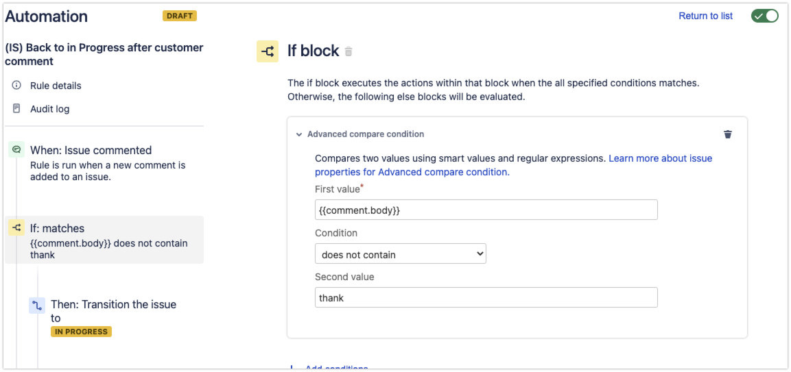

The automation will look like

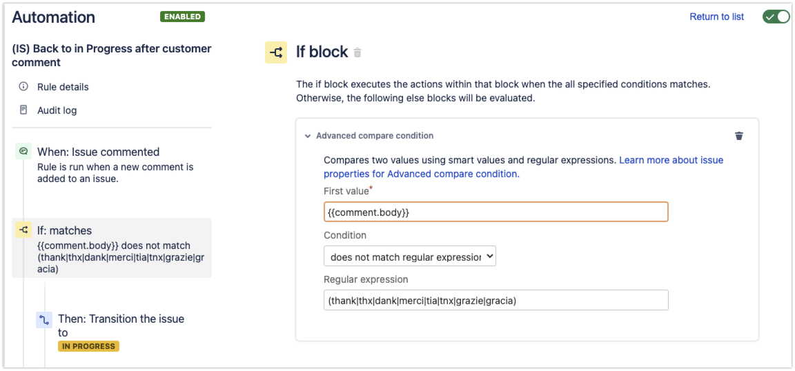

However I realised a strange behaviour:
- When using the condition "does not match regex" the issue will be re-opened no matter what the reply is - so even if the comment contains something from the regex
- When using the condition "contains regex" OR "exactly machtes regex" the issue will remain resolved - no matter what the reply is
