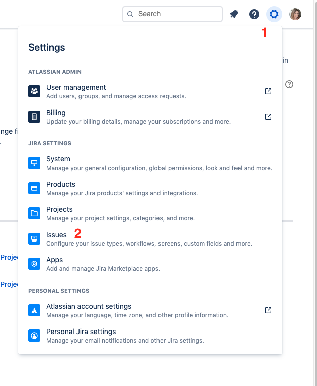

Perform the following steps in Jira.

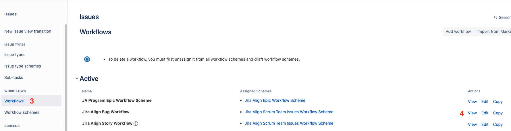

1. Click on the Settings cog
2. Select Issues
3. Click on Workflows
4. Click View on the appropriate workflow

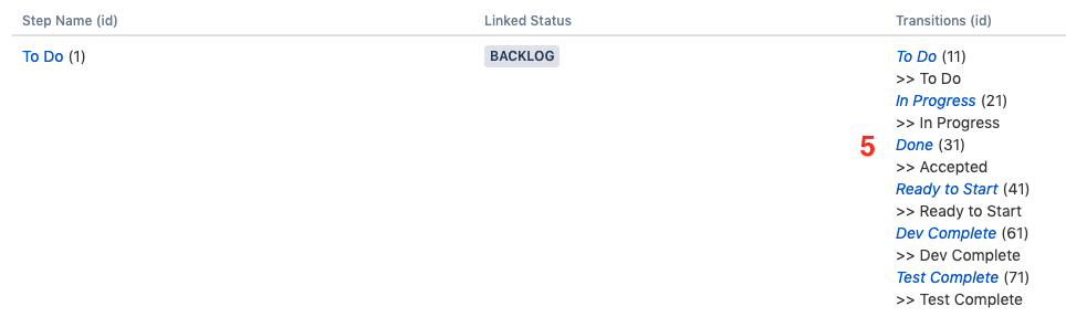

5. Click on the Done status in the Transition (id) column

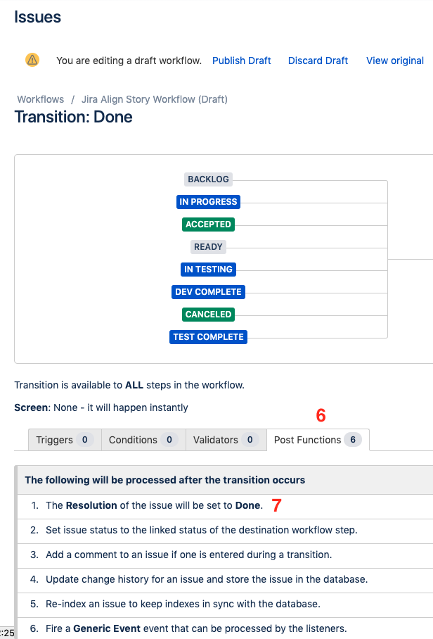

6. Click the Post Functions tab
7. Ensure there is an option listed for, "The Resolution of the issue will be set to Done."

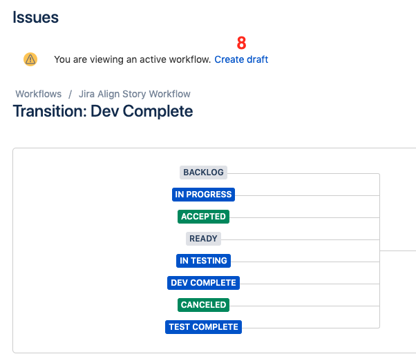

Use these steps if the Post Function isn't listed.

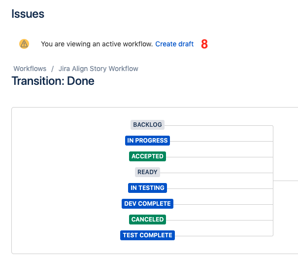

8. Click Create Draft
9. Click "Done"
10. Click the Post Functions tab

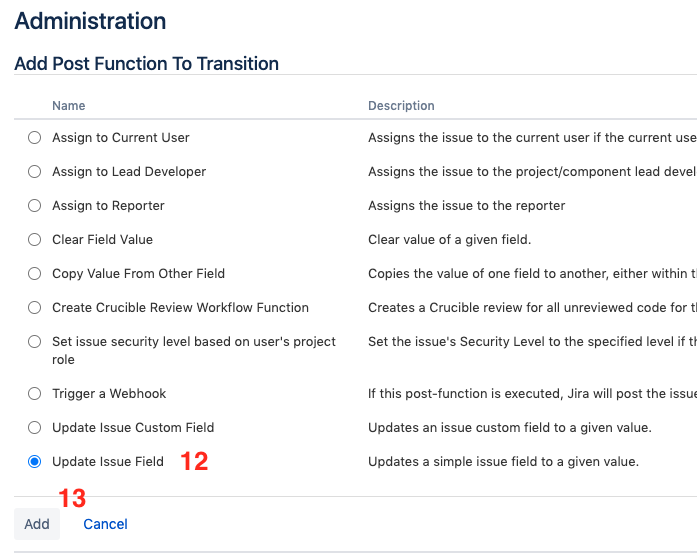

11. Click Add post function
12. Select the radio button for "Update Issue Field"
13. Click Add

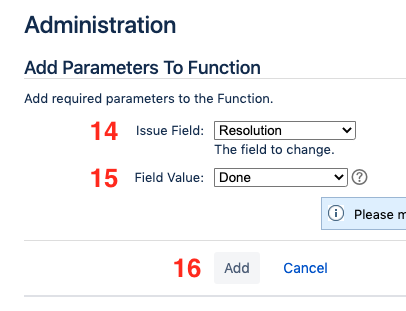

14. Select "Resolution" from the Issue Field dropdown
15. Select "Done" from the Field Value dropdown
16. Click Add

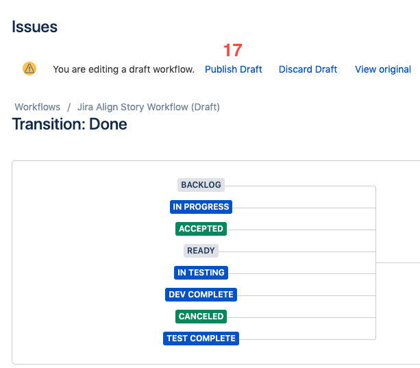

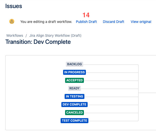

17. Click Publish Draft

Follow the same steps above but select a non-"Done" status for Step 5. Then pick up here with Step 7.

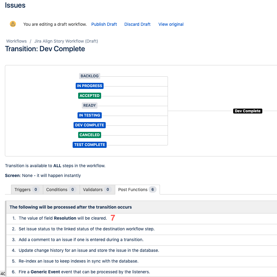

7. Ensure there is an option listed for, "The value of field Resolution will be cleared."

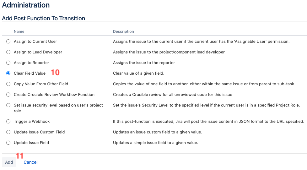

9. Click on Add post function
10. Select the radio button for "Clear Field Value"
11. Click Add

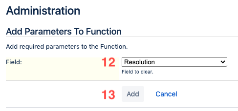

12. Select "Resolution" from the Field dropdown
13. Click Add
14. If Post Function is added, click Publish Draft at the top
