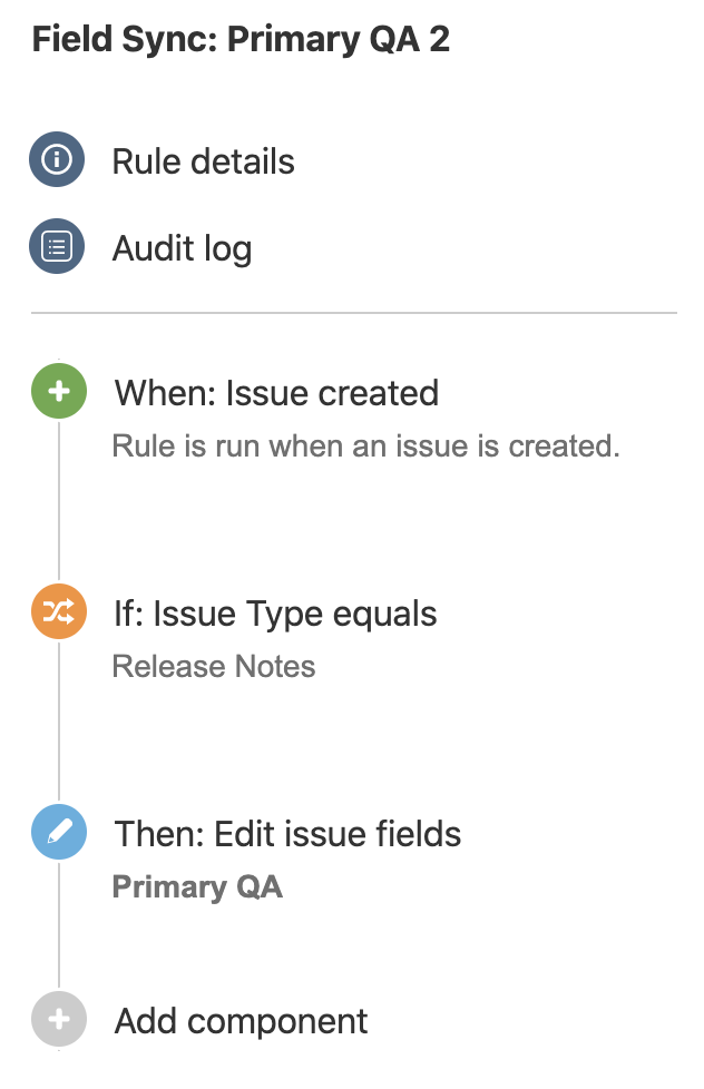

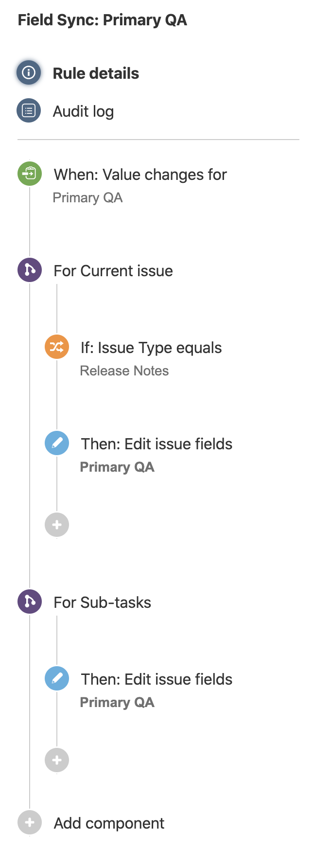

In this project there is a sub-task called "Release Notes". There is also a custom field called "Primary QA" that exists on both the Release Note sub-task, and the parent issue. I would like to make sure that the "Primary QA" value of the parent is always in-sync with the "Primary QA" field in the "Release Notes" sub-task. These are the two scenarios I'm trying to make work.
- When the "Primary QA" field is changed in the parent issue, the change is reflected in any existing "Release Notes" sub-tasks. (Currently working with the "Field Sync: Primary QA" automation rule below)
- When a "Release Note" sub-task is created for the parent issue, the new sub-task's "Primary QA" matches what is in the parent issue. (Currently working in "Field Sync: Primary QA 2" automation rule. Attempted as the second branch chain in "Field Sync: Primary QA" automation rule).
It seems I can trigger on when a field is changed, or an issue is created, but if I could trigger on both states, then it seems like I could work through the logic in the automation rule.
