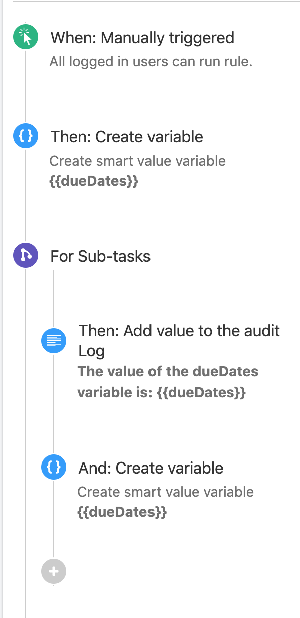

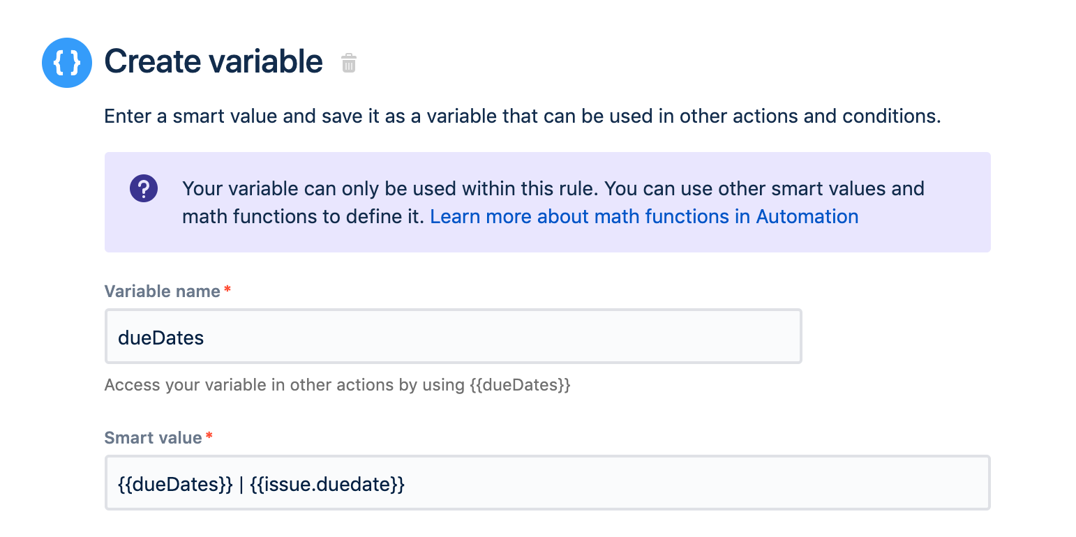

If I open up a branch to loop through the subtasks of the parent issue, then I can get the subtasks' due dates, but I can't set them to a variable that I could then use outside of the loop, I don't think. I tried creating a variable outside the subtasks loop, then re-assigning that variable inside the loop, but it didn't work (Screenshots attached).
So. I'm stuck. Is there a way to concatenate values and put them in a smart variable, as I've tried to do here? Then I could separate the string into a list and iterate through.
