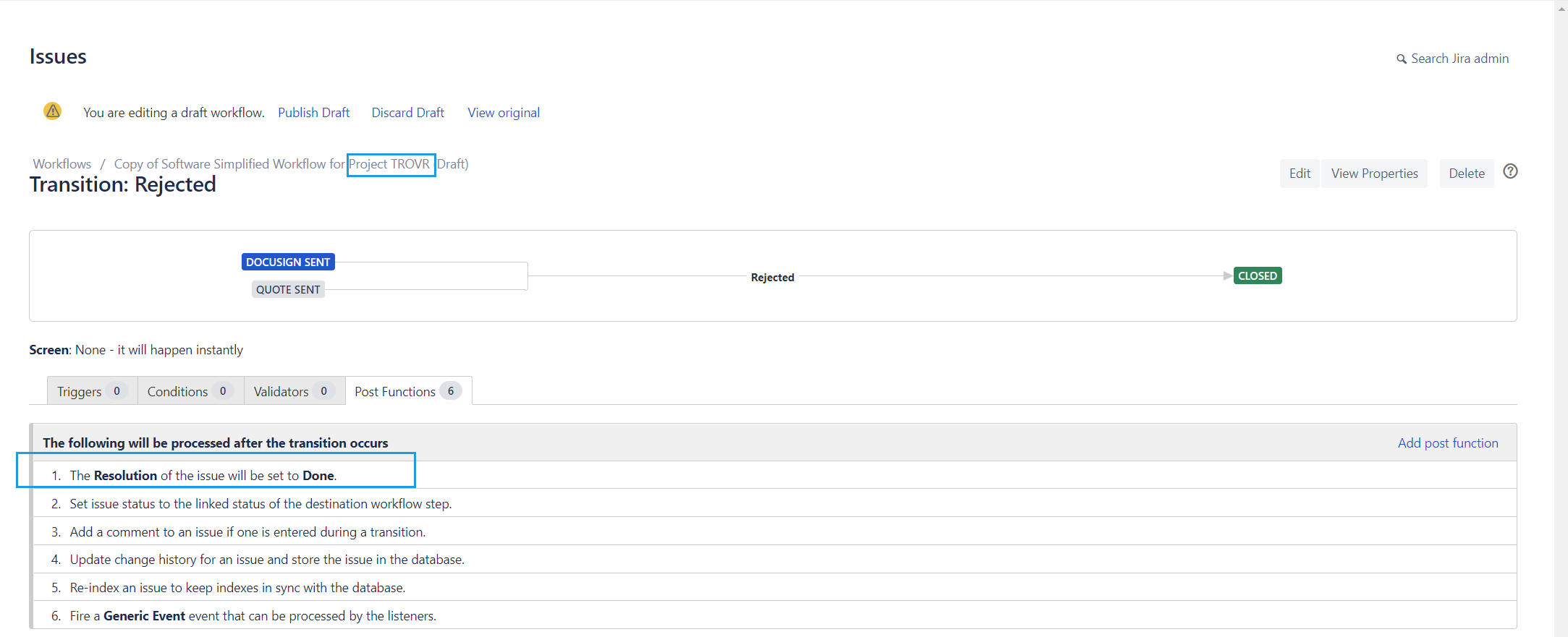

- I setup a new workflow for a different project (TROVR) and everything works great. (See Pic A)

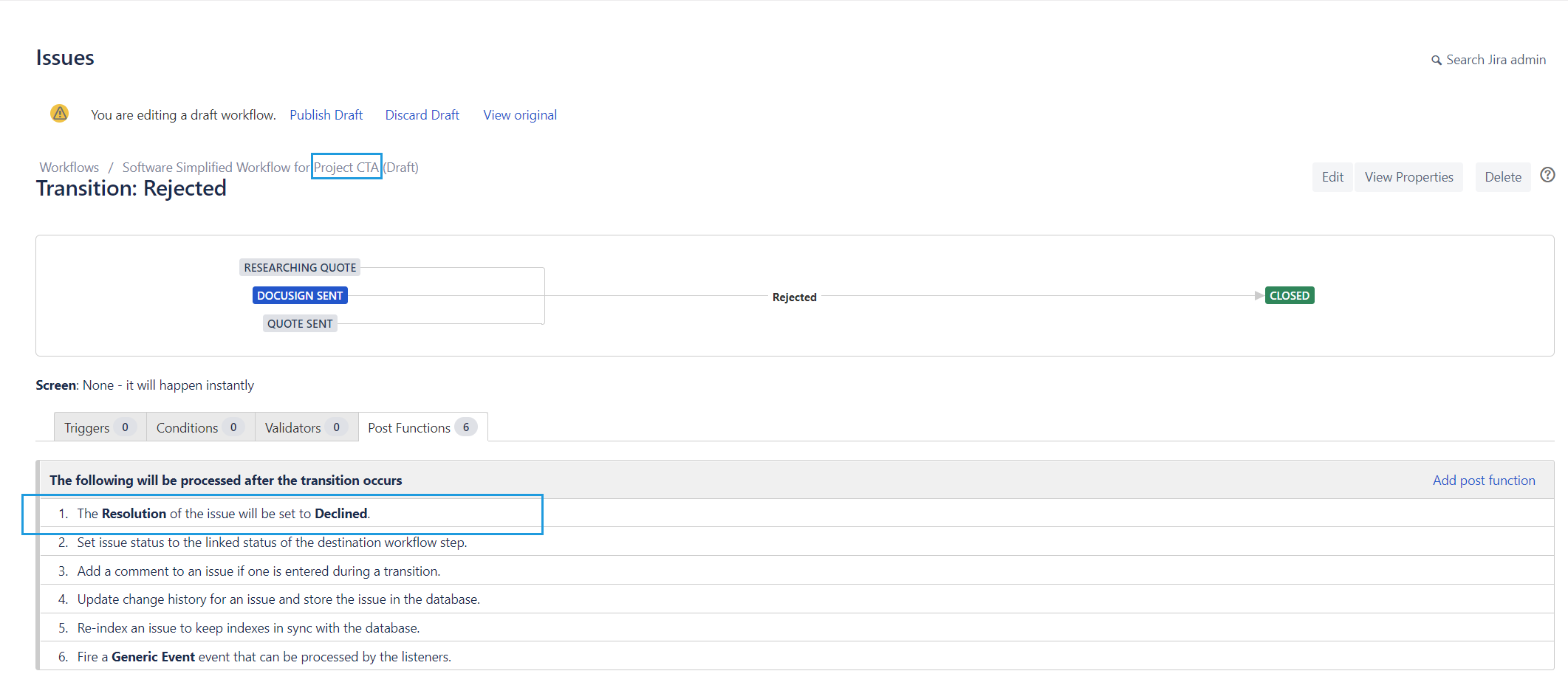

- I have setup the first post function as "The Resolution of the issue will be set to Declined". (See Pic
- I moved it to be the second post function. Didn't work.
- I moved it to be the last post function. Didn't work.
- I used the default resolution of Done. Didn't work.
- I deleted the "Rejected" transition and re-created it. Didn't work.
- I used the workflow for TROVR (see #1). Didn't work.

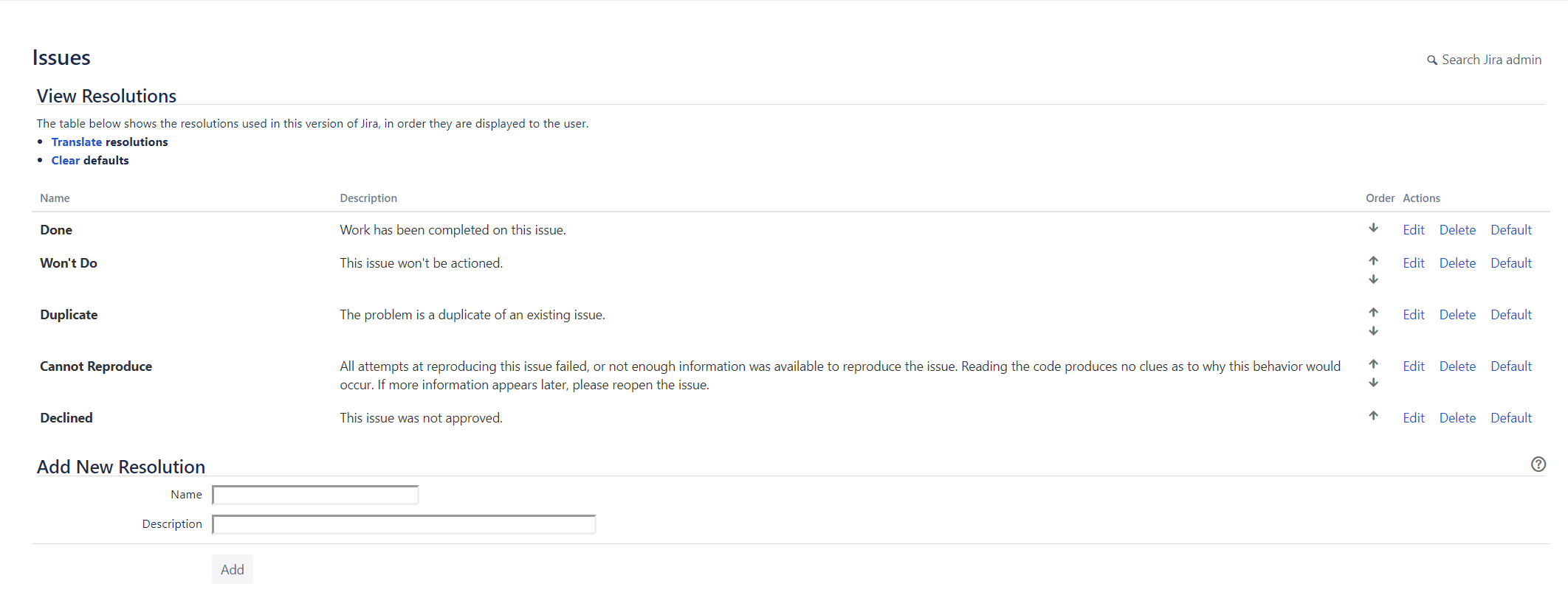

- I verified the Resolution of Declined is correctly setup. (See Pic C)

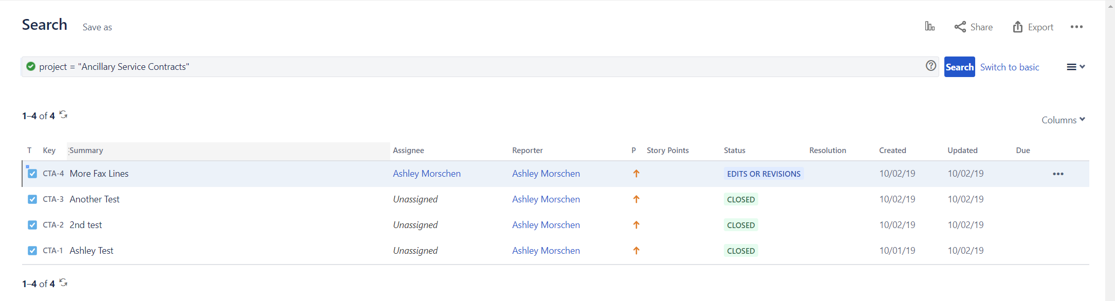

- You can see that for my 3 test issues, the resolution isn't set at all. (See Pic D)

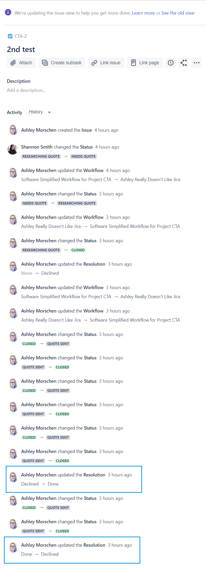

What I did find is that the history of the issues shows I've set the resolution (when it transitions) but as soon as I re-run the search, the resolution is still showing empty. (See Pic E)
Pic A
