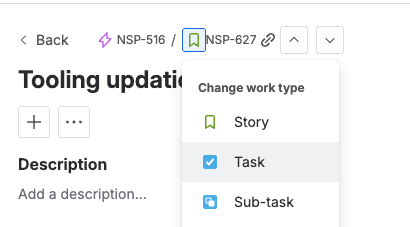

Ajay _view26_
January 15, 2026
A story can indeed be converted into a Task. Can you please check the Project Settings and make sure the Work-Item types are properly configured and available?
If so, you should be able to switch the type as shown below
