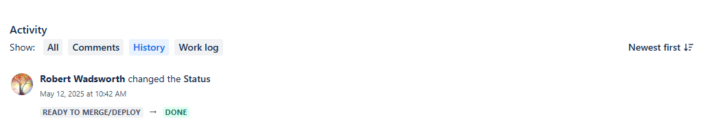

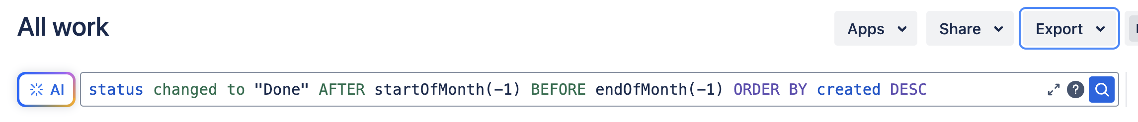

When an engineer marks there ticket to "done" via "Status Category", I believe jira creates an internal time stamp that surfaces when you query natively with in Jira. The head of our engineering team runs this query (attached) to see what tickets where created within a given timeframe. When the csv is exported an additional column "Status Category Changed" is next to "Status Category". We need to surface this column in our stitch integration to be able to automate/build this report in looker.

The JQL you show is searching for issues that had their Status changed to Done. The JQL is not specifically using Status Category in the criteria.

When an issue undergoes a change of Status, and the starting and ending Status values are members of different Status Categories, then the Status Category Changed timestamp will be updated. If the starting and ending status are in the same category the timestamp is not updated.
So, the Status Category Changed timestamp may not reflect when the issue Status was changed to Done if the Status changed to Done from another Status value that is also in the Done Status Category.
