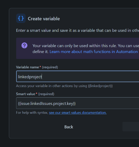

  • Read the project key from the linked issue.
  • Create a variable from the project key.

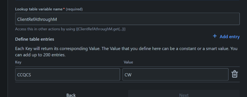

  • Use that variable value to reference the lookup table key, to then find the value to set on the Clients field.
"update": {
"Clients": [{ "add": {"value": "{{ClientRefAthroughM.get({{linkedproject}})"}}}}]
ClientRefAthroughM = lookup table name
linkedproject = variable

Celina Kincaid November 18, 2024
Thank you Bill!!  That helped.  The automation is running but it's finding an empty value.
Can you peek at my attached files?  It's saying
"PLAYG-65 (Option value '' is not valid (customfield_10097))"
Not sure why it's just seeing a quote and not finding the CW from the criteria.Snip - Audit log - Automation - Jira - Google Chrome (7).png Snip - Audit log - Automation - Jira - Google Chrome (8).png
I started adding log messages and could see where it was breaking.
I figured this out.  I changed my variable to {{issue.key.substringBefore("-")}} to strip out the project.
Thank you!!
