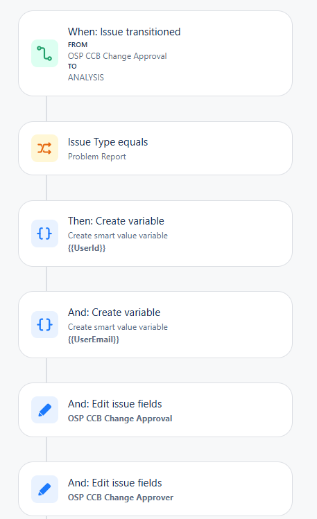

I have an interesting issue, I have the following automation rule:

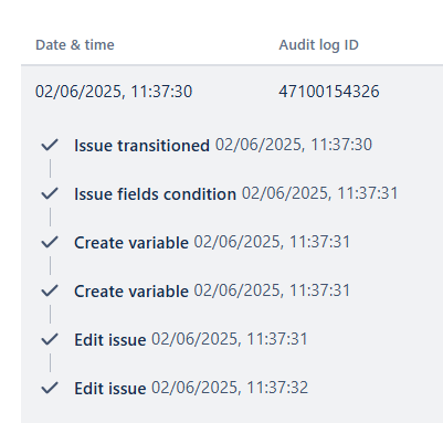

This rule performs as expected. Here is audit log of latest run:

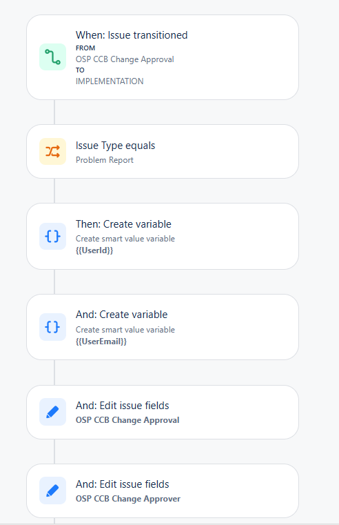

I then have this rule which was copied from the above rule and the only thing changed was the destination status in the first step. Destination status is valid and was selected using the drop-down menu.
However, this rule does not work

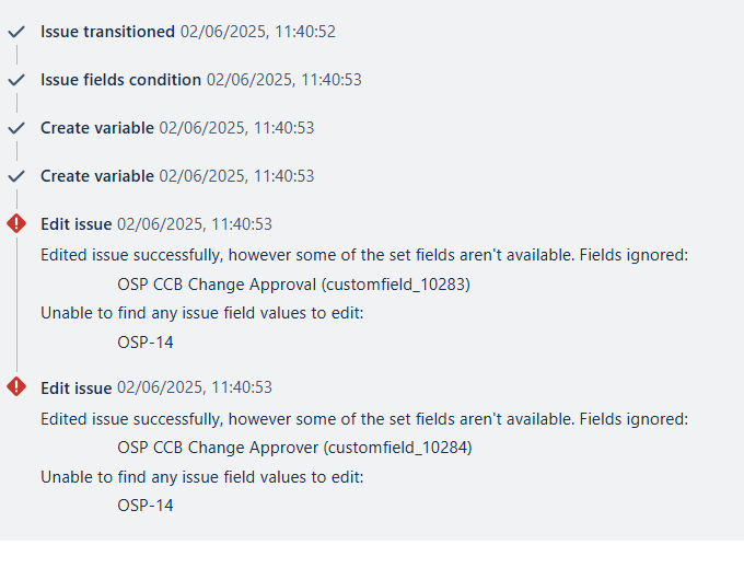

Since there is nothing different about the two rules other than step 1 and that is working, I don't understand why the edit issue steps have a problem. Literally a copy of a working rule.

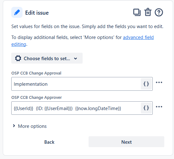

john.monteith
February 10, 2025
  1. I combined both edit issues into one action, still has the same error, here is screenshot.A05 edit issue.PNG
  2. Trigger is manual.
  3. No
  4. Single project
  5. Default Automation by Jira
Bill Sheboy

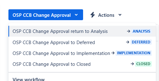

john.monteith
February 6, 2025
The transition is a valid transition:

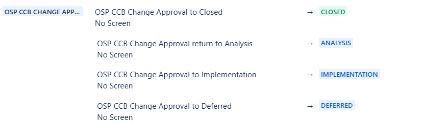

john.monteith
February 6, 2025
There are no transition screens for any of these status changes. The issues are simply changing status
Bharat Kalia
February 6, 2025
yes @john.monteith , but can you check the transition screen? That pops up when you move to implementation. Is the field is there on that screen?
john.monteith
February 6, 2025
Like Bharat Kalia likes this

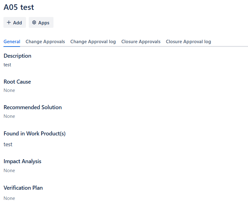

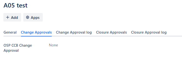

john.monteith
February 6, 2025
This is the General "tab" of the edit screen, the fields to be edited are in the 2nd and 3rd tab, I have included a screenshot of the 2nd tab.
