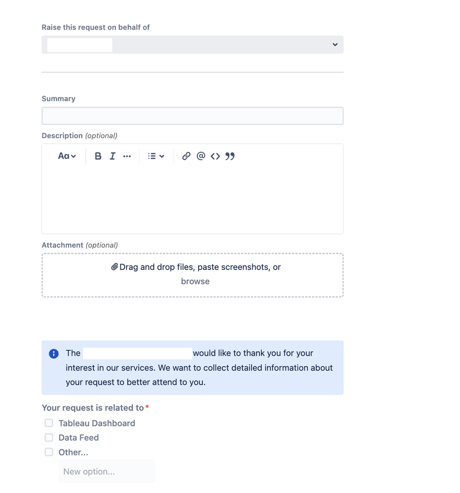

My team and I operate a JIRA Service Desk page where our customers can complete forms to create support tickets.
Presently, I am seeking a method to populate a form via the JIRA Service Desk API. However, thus far, I have been unable to find an endpoint that adequately addresses this requirement.
Firstly, I m trying to find a GET endpoint to retrieve all the form fields that require completion.
Additionally, I need to find POST endpoint to submit a JSON containing the responses, which would then automatically generate the form.
Can anyone assist me with this matter?
Example url of our form and example of one of our forms:
https://company_servicedesk/plugins/servlet/desk/portal/80/create/2803

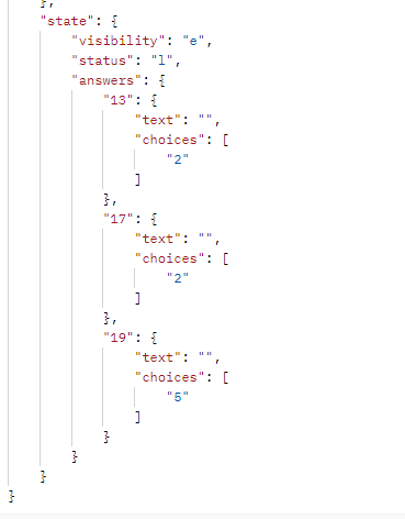

Forms Response:
Endpoint: https://api.atlassian.com/jira/forms/cloud/{org-id}/request/{issue-key}/form/{form-id}
In this get you'll see all details of the fields in forms and options. The answer you'll see in the final inside state {answers}.
Is a different structure than Jira, so take some time to read and understand the documentation to GET and to POST values.

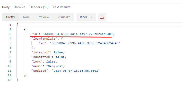

Good afternoon, I managed to get the forms ID, but I am not having success in the post, even passing the forms ID it returns 404, what would be the correct endpoint for the call?
