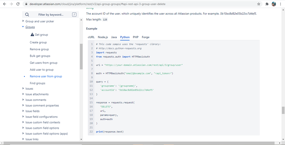

Apologies for the late reply, I'm using Jira Cloud and Confluence REST API. For your reference please see the image below.
@Prince N Please see the image above for the REST API I'm using and the user is no longer exists in the users after executing this.
@Prince Nyeche - ELFAPP Thank you for your answer. I found out that the URL I'm using is for the user that's why it delete the user and unable to remove in a specific group.
