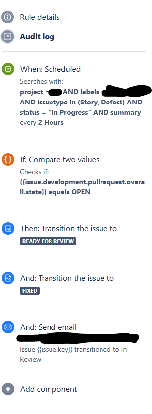

We are using Jira Data Center and I have created an automation rule to change the status of an issue if a pull request is opened.

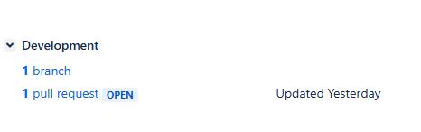

The pull request appears in the development panel as you can see in the screenshot and the name of the ID is in the title of the pull request.

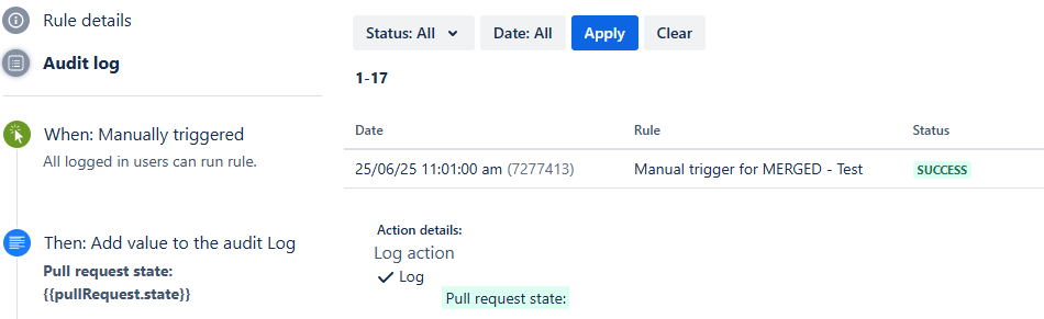

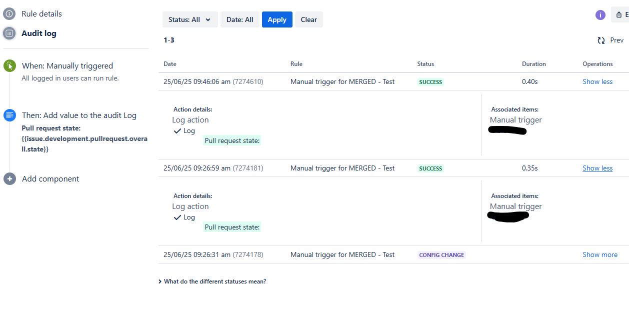

Going to attach the automation rule created and the manual trigger to see the logs.

AlexandruPB
June 25, 2025
Hi @Manon Soubies-Camy
I saw that for Data Center is different, but will try with pull request.
Thank you,
Alex
AlexandruPB
June 25, 2025

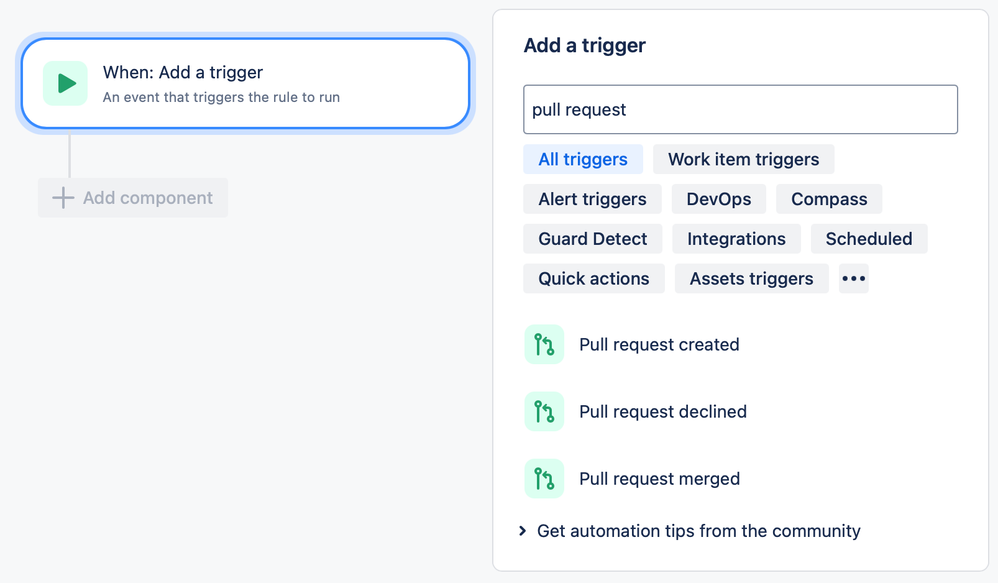

Manon Soubies-Camy
June 25, 2025
Apologies if that wasn't clear, I actually meant switching the trigger rather than the smart value.
That said, it looks like Data Center may not support pull request triggers at all. Could you confirm whether you see any of these options on your side?
