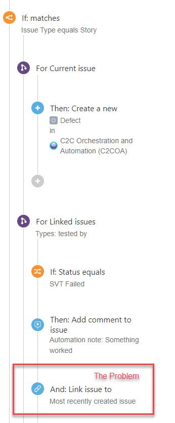

The Setup:
A 'story' Issue contains a linked 'test' issue of "tested by"
When the test issue transitions to a fail, it triggers a transition on the story issue which triggers this automation flow.
When this automation flow is triggered, I create a 'defect' issue using a current issue branch and link the defect as blocking to the story.
I then have a second branch "for linked issues", to the story, which targets the test issue.
The Problem:

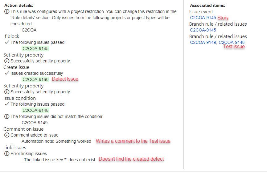

I am attempting to link the test issue to the defect issue by using the 'most recently created issue' from the 'link issues' action, but the issue key of the created defect issue can't be found; however, it is in the log output.
There are several articles similar to this but none of the solutions work.
LOG OUTPUT:

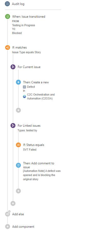

Rai Warbasse
April 18, 2023
Thank you for that but it is contained with a single 'if' rule. Here is the whole view:

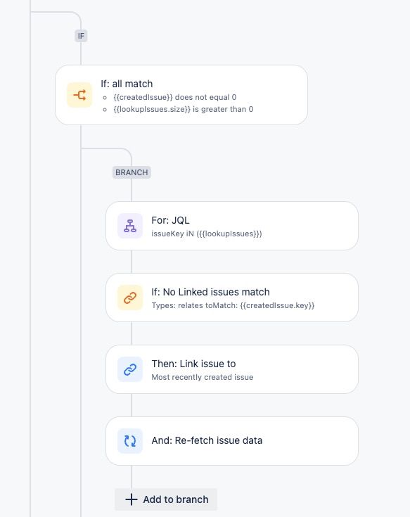

Rafa
March 15, 2024
Another work around is to define `{{createdIssue}}` at the top level, that will make its scope global. (as read somewhere in one of the multiple documentation pages, can't remember where).
So, you define  {{createdIssue}} = 0
and after creating the issue, the variable will have the new issue's details.
then, you may want to add somewhere "if  {{createdIssue}}  != 0 then..etc", to check the branch where the new issue was created was actually entered

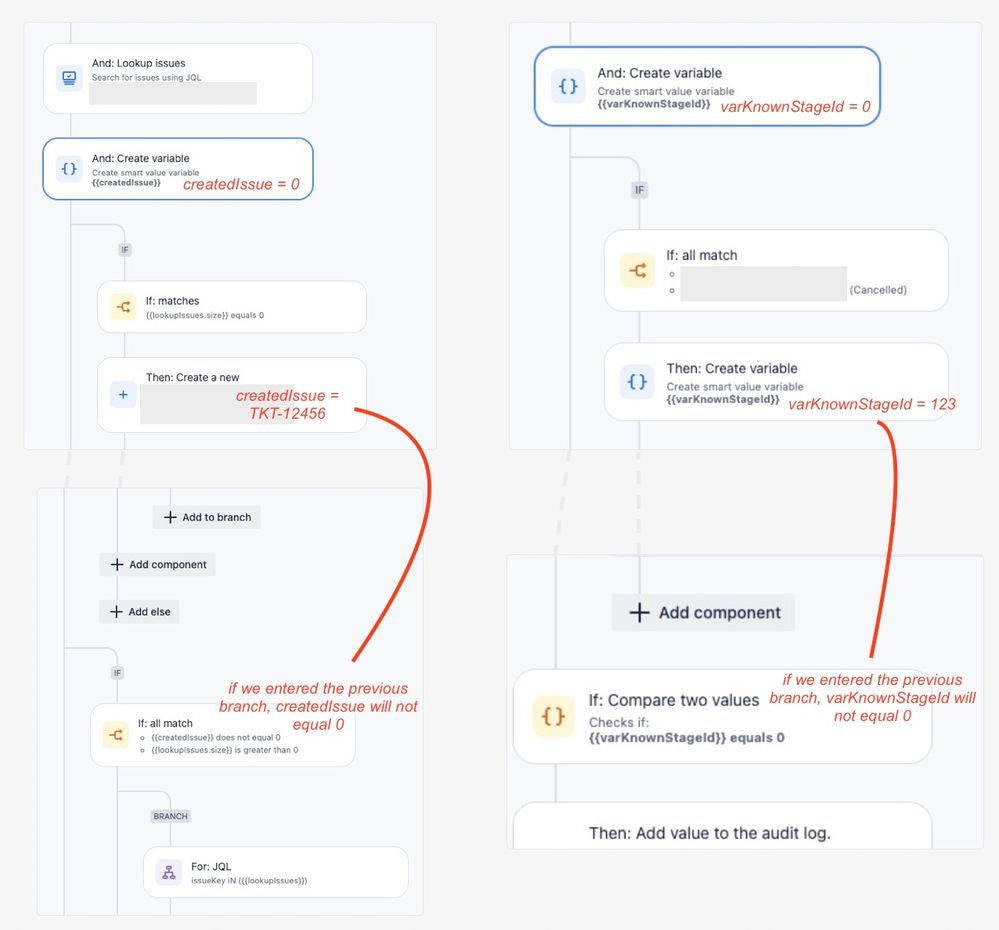

Rafa
March 19, 2024
Hi @Bill Sheboy ,
yes it works, I use it on a couple automation rules. In one of them I use it to get the "Most Recent created issue key" to link it to others, but for "reasons", I need to do it outside of the branch where the issue gets created. So I store the key, and lower down the execution, I check the key of the issue created earlier. (see screenshot of 2 rules)
This was described by an "Atlassian Team" user in either an article or an answer (I can't remember or find where, since I've opened hundreds of tabs in the past weeks).
Regardless, the simplest fix for the original rule was just to remove the branch on current issue, as the rule structure did not need it.
Correct. Your answer solved the OP's issue by avoiding the problem to begin with. Whereas my answer gives a more general solution (or workaround) to the "Most Recent created issue key not found in automation" problem. Win-win : )global var.jpg
PS: Where do you get that branches are run "in parallel and asynchronously"? Rules doe run in parallel and async, but branches within an automation rule seem pretty sequential to me.
Maybe you thought I meant global variables across automation rules or executions of an automation rules? (I didn't)
