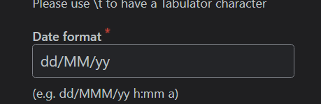

I am getting the below error when importing CSV file into Jira.

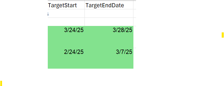

Here is my CSV file date format:
Here is the date format i chose during the import

Hello @Haile, Eskinder
The format you chose is day/month/year, but the data on you file is apparently month/day/year.
Try MM/dd/yy
Thanks for the response! That was bad on me:)
I just tried it with MM/dd/yy and i am still getting the same error. But I will double check in the morning to make sure I am not doing something wrong.
Thanks
Are you trying to import data to an existing Jira project?
Can you confirm for us the field types in Jira for the two date fields you are trying to populate?
Can you show us a sample of the raw CSV file text showing data in those two fields?
@Haile, Eskinder Also, dont try to change the jira date format while importing based on your CSV file. instead, try to match date format of your CSV file with the Jira date format.
@Trudy P Claspill Yes, I am trying to import data to an existing project.
Here is a sample data on the csv file:
| Issue ID | Acceptance Criteria | Summary | Parent | Assigne | Description | comments | Label | Agile Team | Status | TargetStart | TargetEndDate | |
| 1 | TBD | some summery here | PORT-1111 | Myself | Project Description | Comments | Some label | IT Team | In Progress | |||
| TBD | some summery here | 1 | Myself | Project Description | Comments | IT Team | Done | |||||
| TBD | some summery here | 1 | Myself | Project Description | Comments | IT Team | Done | 3/24/2025 | 3/28/2025 | |||
| TBD | some summery here | 1 | Myself | Project Description | Comments | IT Team | Done | 2/24/2025 | 3/7/2025 |
Thank you for that additional information.
What is the Type of the project into which you are trying to import the data? Get that information from the projects list available from Projects > More Projects > View All Projects.
so i did an export of some of the project records with some target date data and I see the target date field as "Custom field (Target Date)" on the export excel file and the exported date has the following date format "9/26/2025 12:00:00 AM". I hope this helps shade some light:)
Thanks
It would be helpful if you could tell us the Type of the destination project and the actual field type for these fields. Then we can try to recreate your scenario to make sure that we give you advice that we can first prove works.
