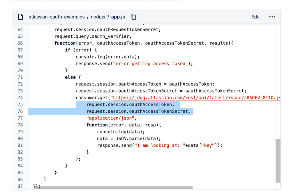

Also if I go down the Oauth1 path, what would these two properties be in translated to in the request headers as?
Thanks,
John
Dario B
July 9, 2021
@John Huynh ,
I am not 100% sure since this is not something I usually do and since this is actually not the best place to get support on development questions.
However, looking at the Oauth1 RFC (authorization header section), I believe they should be oauth_token and oauth_consumer_key:
