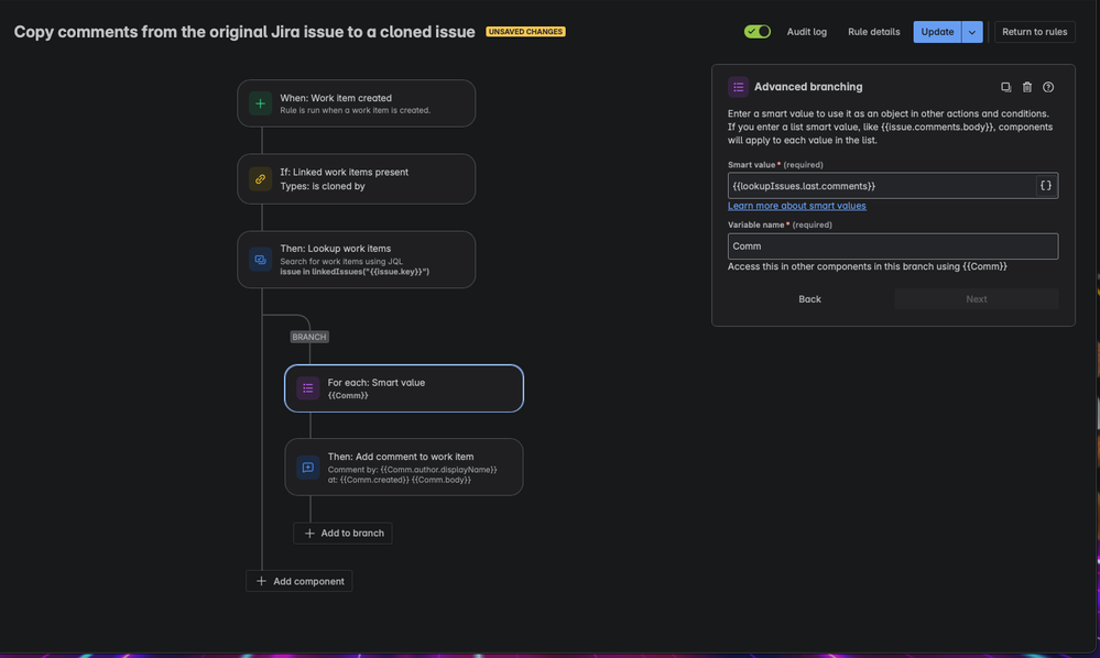

Jira Cloud Automation Cloning issues between projects with Comments. I have tried the article published by Atlassian, https://confluence.atlassian.com/jirakb/how-to-copy-comments-from-the-original-issue-to-the-cloned-issue-1236601599.html, but it returns "No Action Performed" once the issue is cloned to the new project.

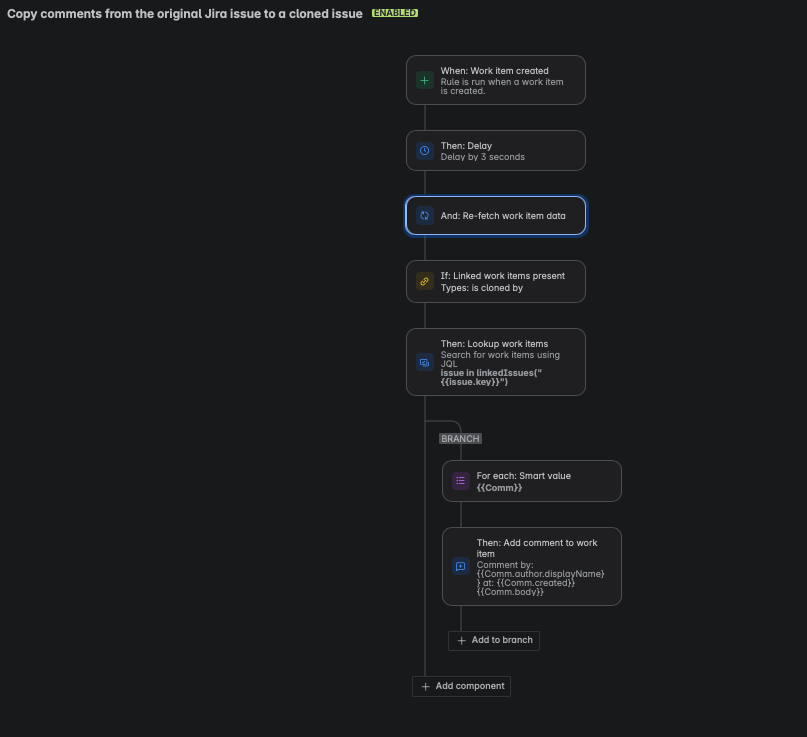

Hey @Brian Taylor
Use 2 more actions:
1. Delay - after item has been created.
2. Re-fetch - after delay.
that should solve your issue.
Ariel.
Brian Taylor
June 4, 2025
Arielei
That did not seem to fix the issue - the comments are still not showing

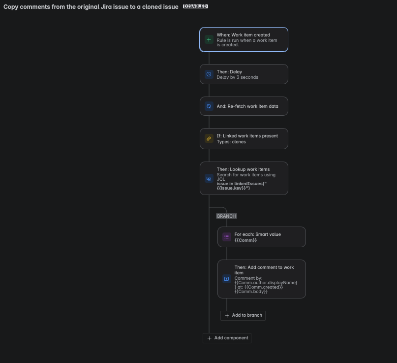

What is the link type on the cloned work item? Is it "clones" or "is cloned by"? The default is usually clones on the work item that is the clone of the original one. If that is the case here that would explain why your automation is not doing anything since it is looking for a link type of "is cloned by".
Brian Taylor
June 4, 2025

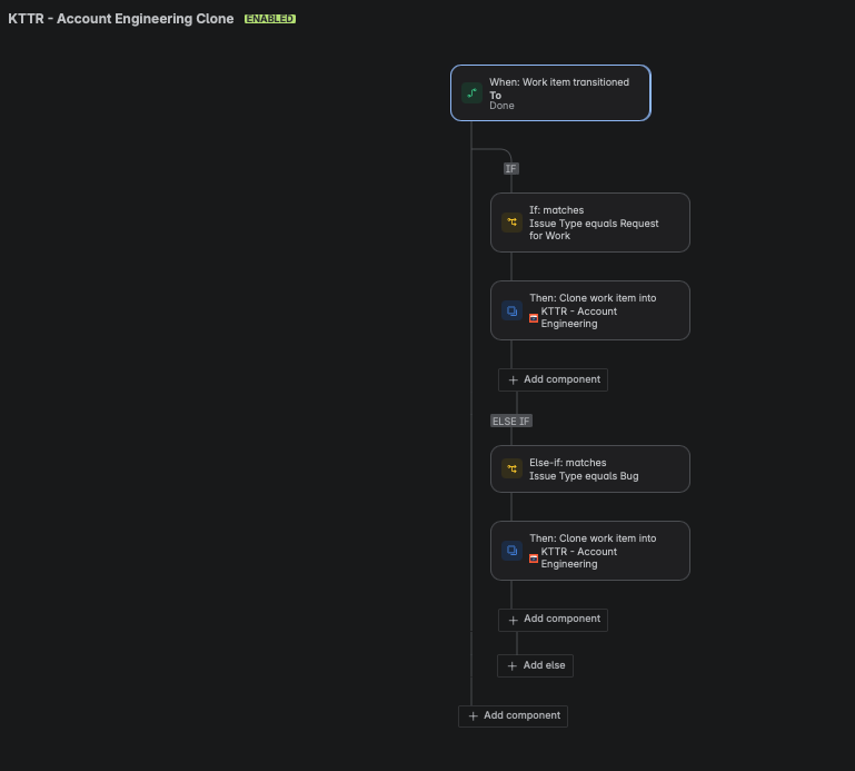

Mikael - I tried your suggestion, but it didn't work, and now I'm not getting any feedback in the logs.  I have attached both automation of the Clone and Comment copy for reference in case you see something else that maybe causing the issue
Screenshot 2025-06-04 at 11.05.41 AM.pngScreenshot 2025-06-04 at 11.05.11 AM.png
Mikael Sandberg
June 4, 2025
On the cloned work item, what is the link type used back to the original work item?
Brian Taylor
June 4, 2025
Both sides are set to Clones
Mikael Sandberg
June 4, 2025
Then I assume that you have changed the default link type, am I correct? As I mentioned above, the default is "is cloned by" as the outbound link on the original work item and "cloned" as the inward link on the cloned work item.
On the automation that should copy the comments, under Rule details have you checked to enable other rules to trigger it?
