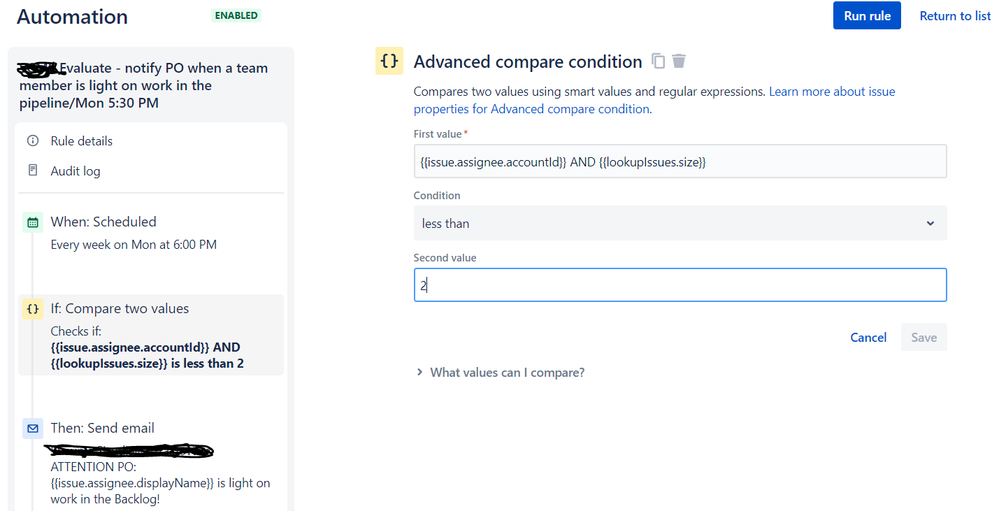

I am trying to create an automation that is scheduled to notify the Product Owner when the count of issues assigned to individuals in Jira Backlog goes below, let's say 2.
This is what I have tried so far.
I am using Advance Compare Condition.

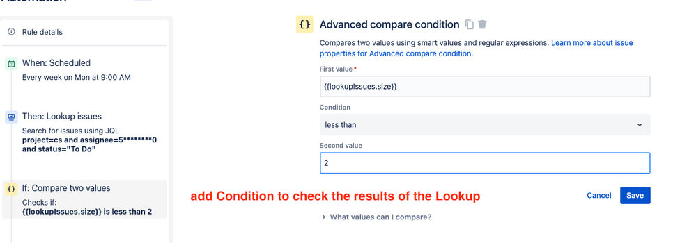

Trudy P Claspill
June 19, 2023

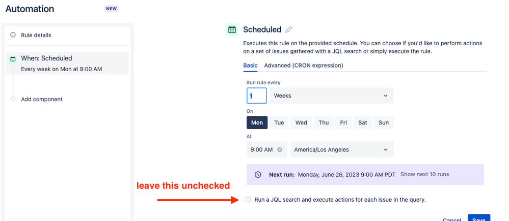

You can still run the rule on a schedule with the Schedule trigger. You just need to not enter a JQL in the trigger itself.

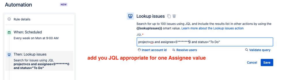

You can then use the Lookup Issues action to execute the same JQL you were using in the trigger BUT for just one user at a time. Then use a condition to check if the lookupIssues.size value is less than your cutoff, and then send the email.
Follow that with another Lookup Issues action to execute the JQL for another one of the users. Check the size of the results, and send the email.
Repeat for each Assignee.
Add the step to send the email. Then copy/repeat steps 1, 2, & 3 changing the JQL each time for a different Assignee.

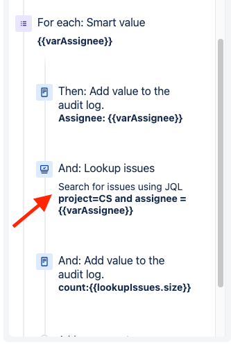

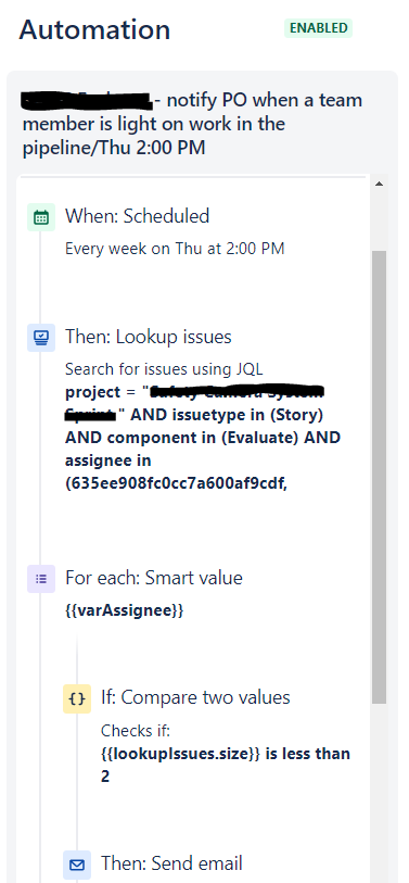

I tried another approach to parse through the individuals in the team with less than x number of Issues in the Jira Backlog; this time using Advanced branching (via New branch component) in the following manner:
Within the Advance branching, have used Smart Value with .distinct as show in the picture to define a variable varAssignee
And then within each of the distinct user, have applied a condition to send the email to the PO if the count of Issues for each individual is less than 2.

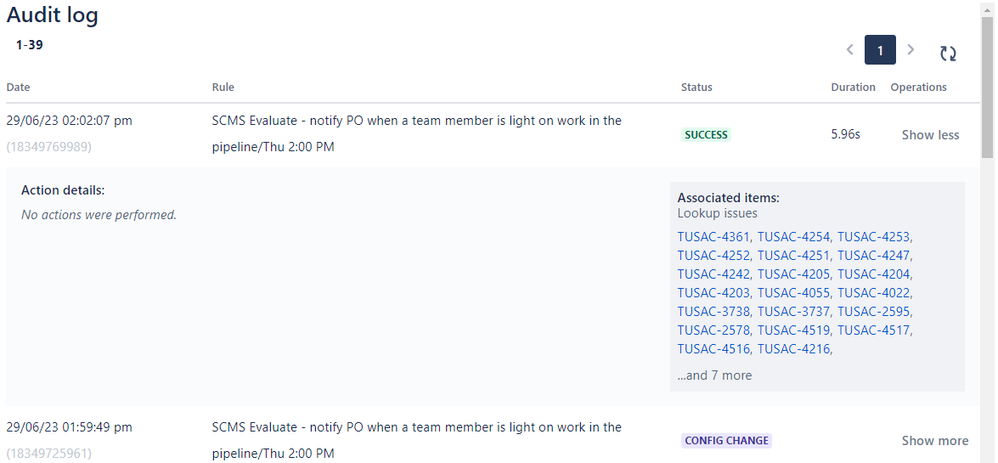

YET, I am not getting any result! The rule has execute as a "success" but only partially, i.e. without any action being performed from within the Advance branching. :( Please see below:
Can either/both of you please guide on what's that I am not configuring correctly and/or how to do it?

Trudy P Claspill
June 29, 2023
The {{lookupIssues.size}} value is not being recalculated inside the branch based on the distinct Assignee value. It is still reflecting the size of the result set from the original Lookup Issues action.
You could add another Lookup Issues action inside the branch to lookup issues based on the distinct Assignee. That will generate a new lookupIsssues result set for each distinct assignee. Insert the new Lookup Issue action inside the branch and before the condition where you check the size. Use the same JQL you used in the first Lookup Issues action, but change the Assignee comparison to use just the {{varAssignee}} variable.

Is my 'is less than' comparison with a number value ("2") in the Advance Compare Condition the reason my Scheduled isn't working? Can I actually make such a comparison:
Cheers,
Shaurya
John Funk
June 19, 2023
Yes, that is your problem. You can only have one value in the First Value field - so just {{lookupIssue.size}}
