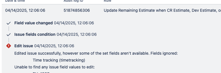

I have a very simple rule to set Original Estimate based on the sum of a couple custom fields. It is failing saying that Time Tracking is not available:

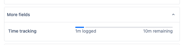

All searches on this site that are similar say that Time Tracking needs to be available on the screen, but it is and so is Original Estimate. I can manually set the value and log time.

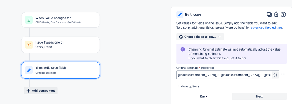

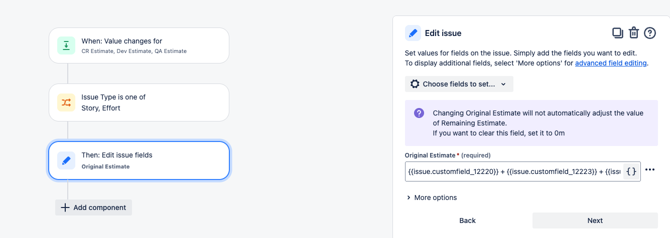

Here is the simple rule:
Am I missing something obvious? Any suggestions would be greatly appreciated.

Hi @Neil Poska
The error messages in rule audit logs do not always indicate the actual problem...
First, your math expression syntax is incorrect.  Perhaps try this in the field, substituting in your fields and assuming they are all number fields:
{{#=}}{{issue.customfield_12345}} + {{issue.customfield_67890}}{{/}}h
If that does not work with the Original Estimate selected from the dropdown list, the same expression could be used with a JSON edit, as described here: https://support.atlassian.com/cloud-automation/docs/advanced-field-editing-using-json/#Time-tracking-and-logging-work

Welcome to the community. I can see how this can be confusing. When they say "on the screen" this means in the configuration screen. You would need Jira admin or product admin access to validate or update this. Also note that on the screen you might need to add Time Tracking as that is not always there.
If you go to the settings cog > Issues > Screens, than you would look up the screen name for the project. This is usually found in the Project Settings > Summary. If you are in the Summary you can navigate to the screen from there. Or you can use the first way I pointed out.
I hope this helps. Again you do need product admin access aka Jira admin. Once you add the fields to the screens then you should be good.

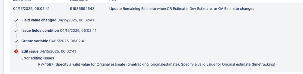

This worked, but now I have a new error:
I am trying to set Original Estimate to the sum of three number fields. Do I need to do some sort of conversion from number to time or something?

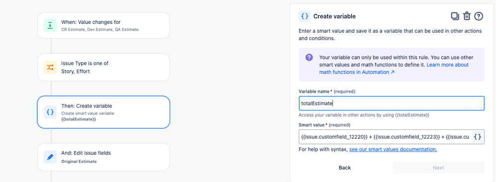

I added a intermediate variable to make thing a little more readable, so my rule now looks like this:
