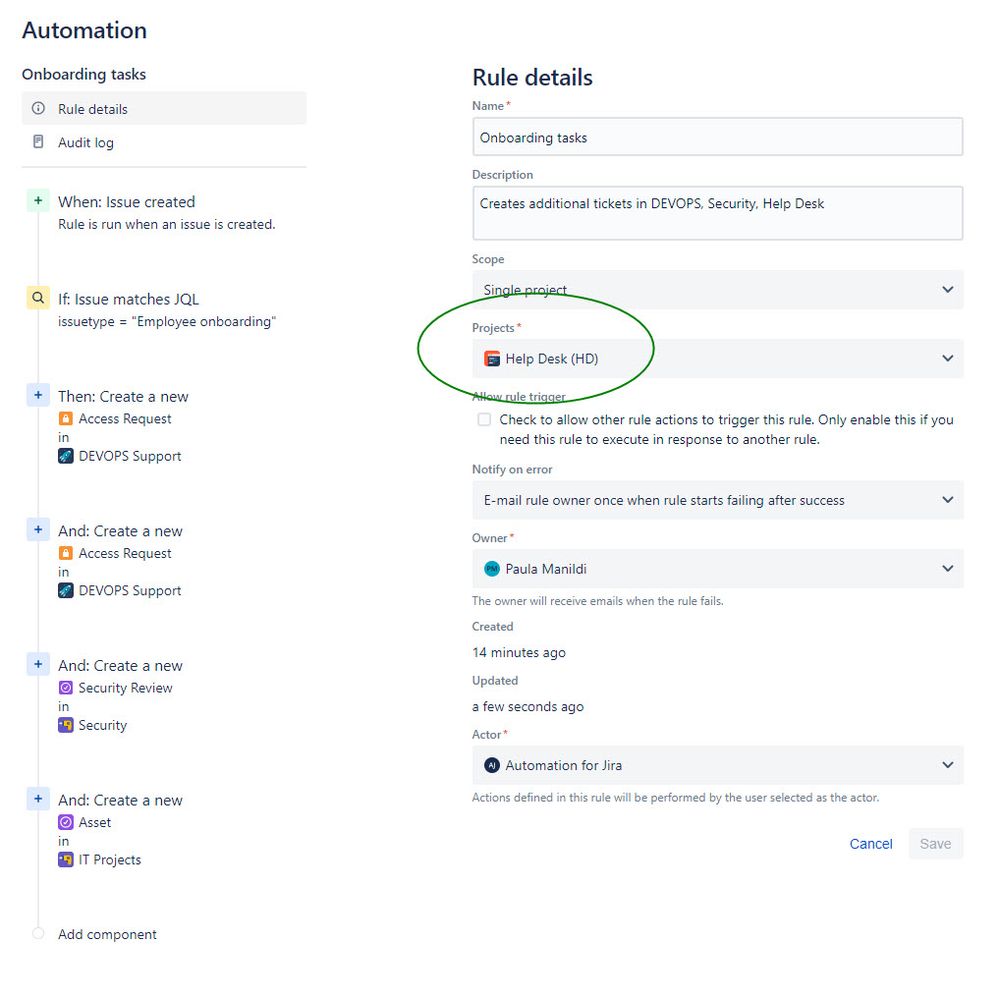

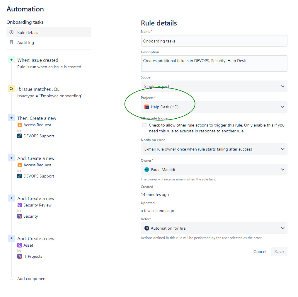

We are setting up a rule when, for specific project (HD) and (via JQL) issuetype, 4 additional issues are created, copying the summary and description and linking to the original (trigger) issue. But it fails with these details:

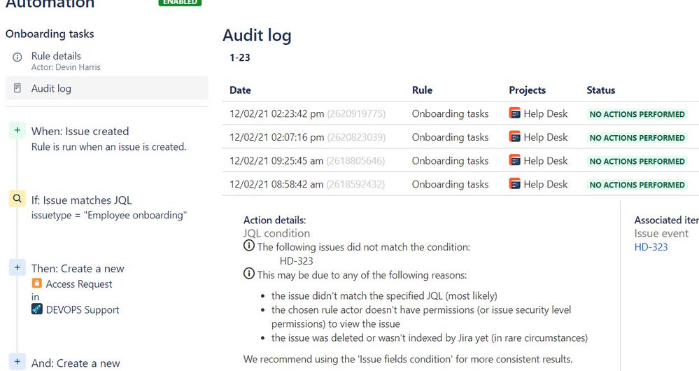

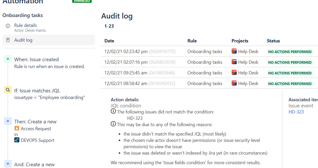

Action details:
JQL condition
The following issues did not match the condition: HD-318 This may be due to any of the following reasons:
the issue didn't match the specified JQL (most likely)
the chosen rule actor doesn't have permissions (or issue security level permissions) to view the issue
the issue was deleted or wasn't indexed by Jira yet (in rare circumstances)
We recommend using the 'Issue fields condition' for more consistent results.
I modified the Actor from automation to an actual user and the error is still happening. What is not correct?

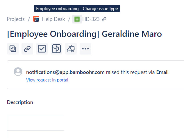

Just from what you shared it looks like the issuetype is Change and the Request Type (Customer Request Type) is Employee onboarding. So I believe you are correct that your JQL needs to be updated.
Hovering over the issue type only displays the issue type and then what you could do, i.e. change it. The issuetype is "Employee onboarding".
Paula,

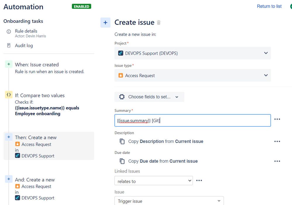

Great, thanks for confirming. Can you use advanced condition compare with the following and as the trigger and see if that works for you.
I have changed the rule to use Advanced compare condition and will see if it works.

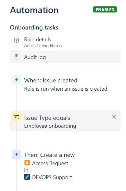

I have changed to select Issue Type equals directly, which is what functioning rules use.
Still waiting for use cases to test.
Using ' select Issue Type equals ' solved the issue. Which I should have done at first, since that is what I had done in the first rule I had created.
It is a little frustrating that 3 ways are presented to do something but only one of them work!
