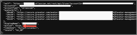

You need to fetch all users via below rest api and then filter the inactive ones. The rest api has pagination, it takes 50 users on each page. You need to modify the startAt parameter if you have more than 50 users.
/rest/api/3/users?startAt=1

Your approach is helpful for detecting issues assigned to inactive users. In your terminology inactive users are the ones that do not have access to Jira anymore. They were deactivated by the Jira admin via user management page.
I guess what @Mahesh Kumar is asking different. He is looking for a way to detect users who haven't logged in to Jira for a long period of time(e.g in the last 90 days). So that, he can deactivate their accounts. In his terminology inactive users are the ones who did not logged in to the Jira for a long time.
