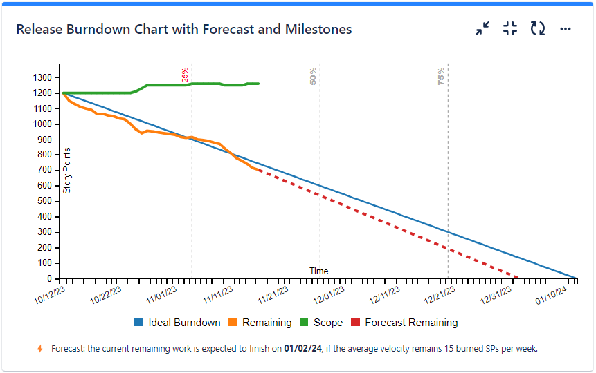

Danut M _StonikByte_
Atlassian Partner
May 14, 2024
Hi @christopher_brooks,
This is not possible with default Jira reports and tools. But you can easily do this by using the Release Burndown Burnup Chart gadget offered by our Great Gadgets app.
This gadget uses a filter or JQL as data source (exactly as you want), can include the sub-tasks, works with any type of estimates and can make forecast.
Find more about this gadget (and the others offered by the same app) in these articles:
You can start with a 1-month free trial. If you have any questions, feel free to contact us at support@stonikbyte.com.
Hope this helps.
