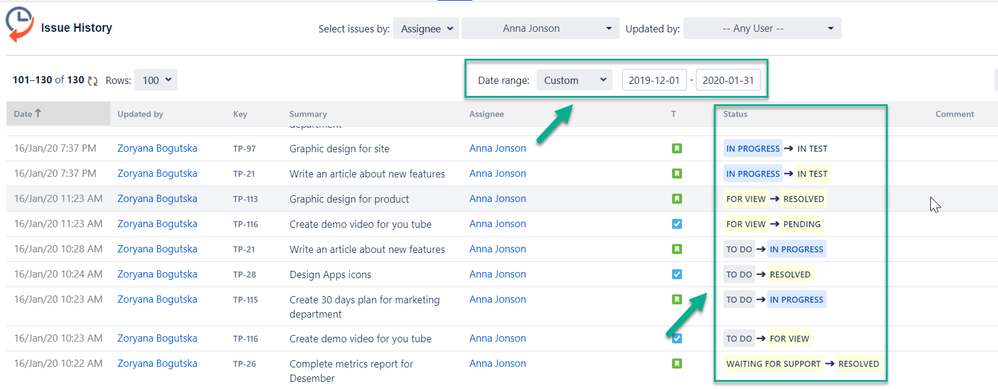

Yes, @mogavenasan is right. To get data about when the issue was in each status, you need to consider a solution from Atlassian Marketplace.
For example, Issue History - lets you view the time and date any issue field was changed (including status changes).
2021-02-23_18-42-26.pngTime in status for Jira Cloud by SaaSJet - allows you to monitor time in each status and date of the first entrance to statuses.
I hope you will find the best solution for yourself.
