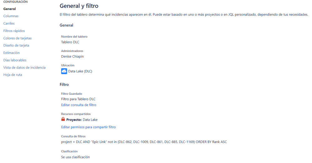

I have a scrum project with a board. I need to filter some issues (exclude those that the have an specific Epic), so I modify the board filter:
This is the new query:
project = DLC AND "Epic Link" not in (DLC-862, DLC-1009, DLC-861, DLC-885, DLC-1169) ORDER BY Rank ASC
I exclude some epics.

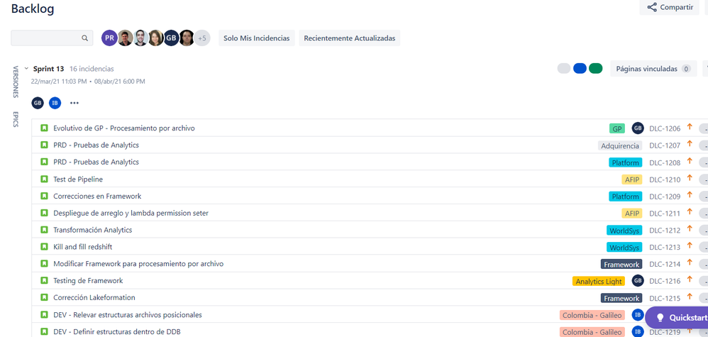

As you can see, the filter works. and it is working in backlog:

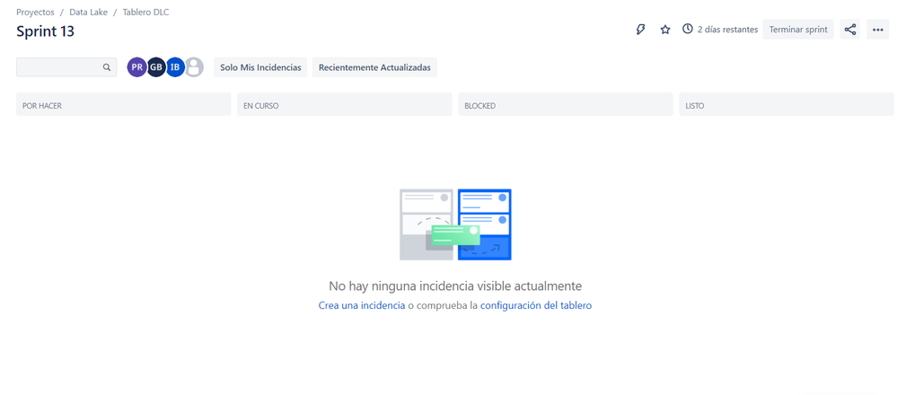

But it is not working when I go to see the active sprint (sprint 13)
If I go back with the changes, I can see all the issues. But it is weird.

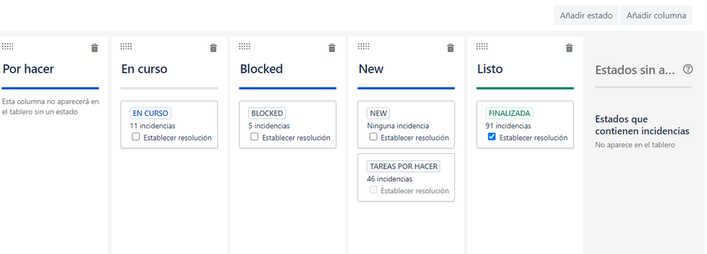

Hi @Chris Buzon, thanks for your reply!
When I go to add a column, I can see how many issues are in those columns.
So, I added the "New" column, and I pass the status "To Do" with 46 issues.
But I still cant see any issue in the column.
Is right how im doing? Thanks!!

I had a similar issue, the problem is that I included the stories based on epiclink, but I didn't include the epics themselves so the stories didn't appear in the sprint view. In my case I wanted to build a board around a specific set of epics so in my example I used "in" instead of "not in" but using the example above, if you change it from this:
to this:
project = DLC AND "Epic Link" not in (DLC-862, DLC-1009, DLC-861, DLC-885, DLC-1169) and issue not in (DLC-862, DLC-1009, DLC-861, DLC-885, DLC-1169) ORDER BY Rank ASC
The board and backlog will be filtered as you expect.
