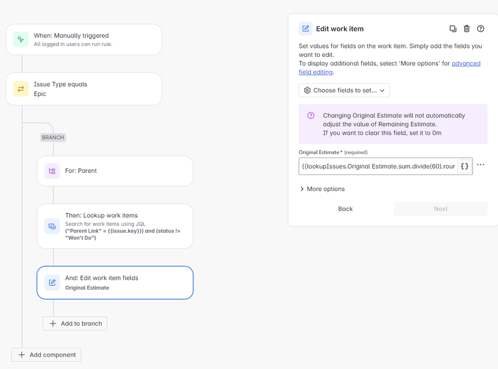

I'm trying to use Jira automation to go over all the child issues of an epic that are not in Done category and sum up their original estimate and edit the epic's original esimate with the sum value.
This is my rule:

It is great that you provided a screen image of the rule. That is helpful. However, you haven't told us anything about the problem you are encountering. What is the output in the rule execution Audit Log? What are the results you are observing that don't match your expectations?
I can state that your use of the "For: Parent" branch is incorrect. What that tells the rule to do is look for the Parent of the trigger issue and execute some steps against the parent. Your trigger issue is your Epic, so you don't need that branch at all.
Remove the branch and see if that resolves whatever problem you are encountering.

There's a lot of questions that could be asked about your use case as well as your automation rule - such as:
  • where are you manually triggering the rule from? If you only allow the rule to be triggered from epics, then the Issue type equals epic condition is not necessary.
  • If you're triggering the rule from an epic, then the for parent branch does not make sense, since you already are at the epic work item.
  • The JQL to retrieve the child items for an epic should use Parent instead of "Parent Link"
With that in mind, maybe you can already proceed to some extent. If not, please provide more details about where you are stuck and/or share details from the audit log so we can better understand where you are and what pieces of the puzzle are still missing.

Hi. Thanks for the reply.
The 1st bullet point was just a safeguard so people won't run on other issue types, but I get your point.
The 2nd bullet point - that was the main issue. Removing that resolved everything.

Edit: Trying to make this rule to work also on subtasks and it's failing. Example: I have an epic with two tasks and one task has a subtask.
Epic: 2d 6h (sum of Task 2 + Task 1)
Task 1: 6h (2+4)
subtask 1: 2h
subtask 2: 4h
Task 2: 2d
I was hoping that the rule will work given I have this JQL ("Parent" = {{issue.key}}) and (status != "Won't Do") on subtasks and then on the tasks and then on the epic.
