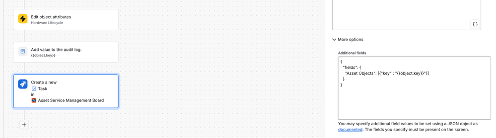

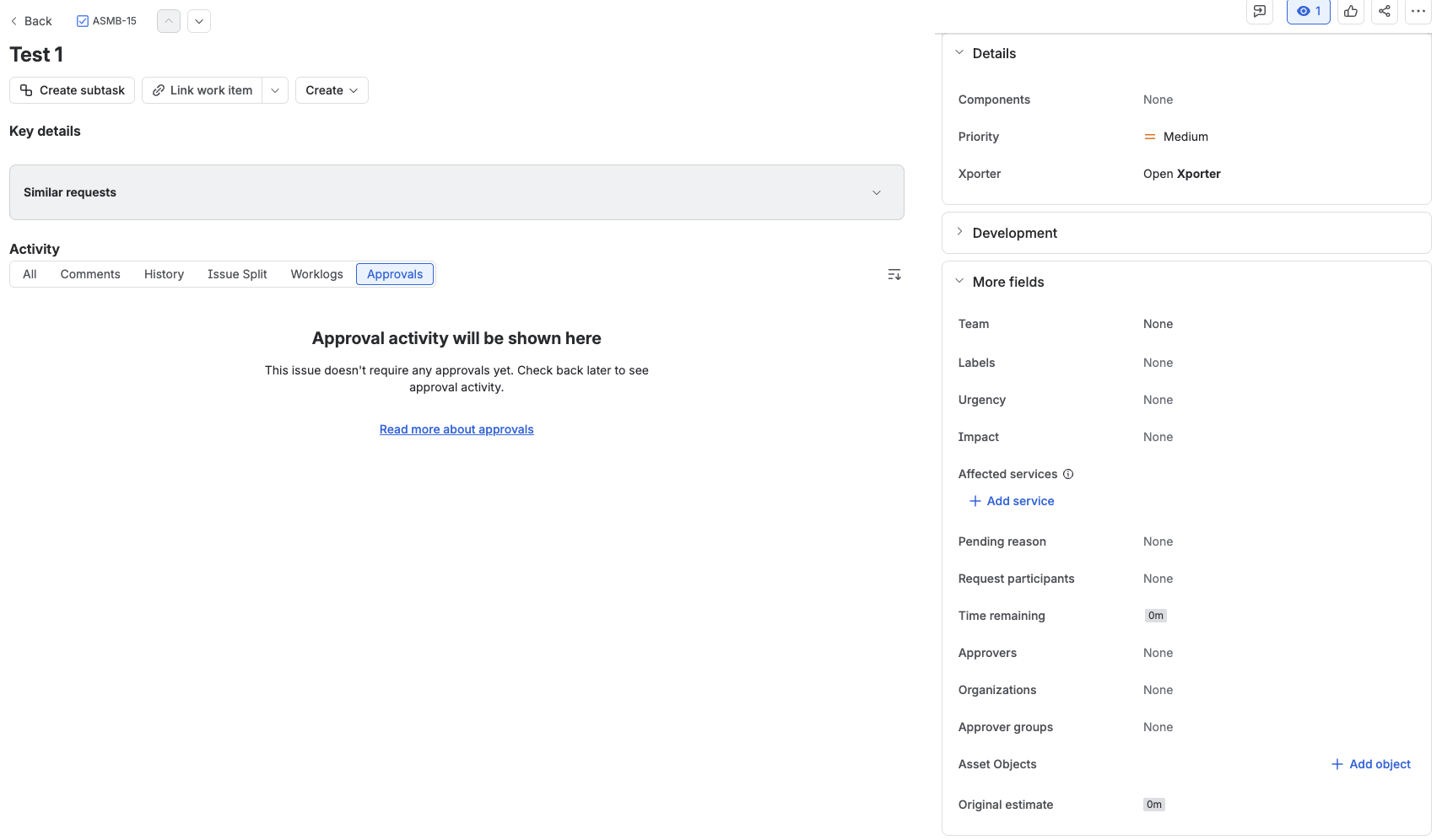

I currently have a flow that I am creating that looks for a change in an attribute and then creates a work order based on that change. The issue I am facing is that I am not able to link the object in the automation flow

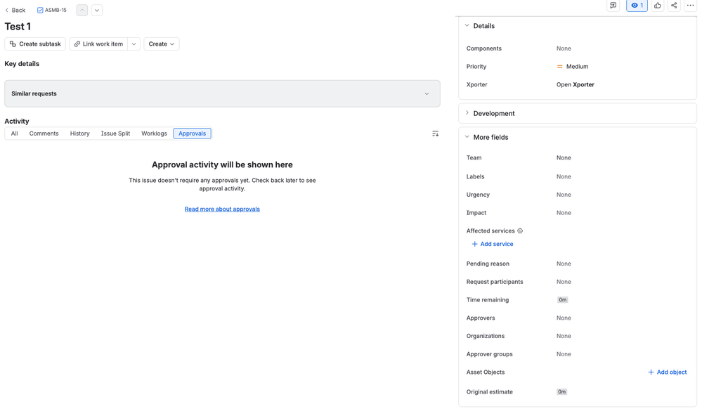

I am not able to set the custom field "Asset Object" in the script, but can do it manually from the task page.
The flow works well as I am able to create the necessary work items with the correct titles, but I am not able to edit Asset Object from the flow.
When I try to assign directly without the "key" method, i.e. "Asset Objects" : {{object.key}} I get the following error "Specify the value for Asset Objects in an array (customfield_16948)"

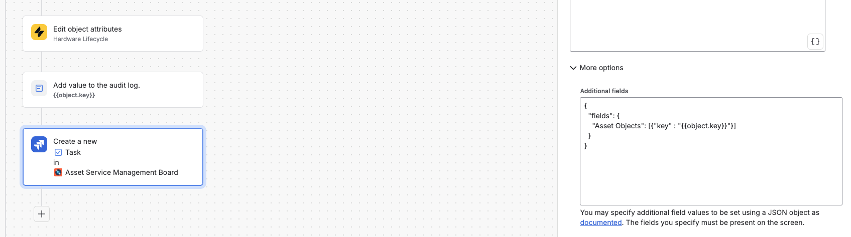

Hola jiranewbi3,
The follow-up confirms that the two main setup checks are already good: the automation completes successfully, and the Asset Objects field is associated with the relevant create screens. That means I'd focus on the value format being passed into the Assets field rather than changing the screen configuration.
The error you quoted is the strongest clue: Jira is telling you that customfield_16948 expects an array. For Assets custom fields in Jira Cloud, Atlassian's documented automation format uses an array containing the Assets object's global ID rather than the human-readable object key.
In Create work item > More options > Additional fields, try:
"fields": {
"customfield_16948": [
"id": "<WORKSPACE-ID>:{{object.id}}"
Replace <WORKSPACE-ID> with your Assets workspace ID. Atlassian documents this JSON structure here.
You can retrieve the workspace ID from:
https://YOUR-SITE.atlassian.net/rest/servicedeskapi/assets/workspace
I'd also add a temporary Log action immediately before Create work item with:
{{object.key}} | {{object.id}}
That'll confirm the Assets branch is carrying the object you expect before the create action runs. The key is useful for reading the log, but the ID is the value you need for the Assets field payload.
Thanks,
James
jiranewbi3
August 11, 2026
Thanks James, that seemed to have done it!.

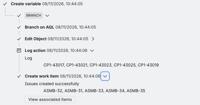

1. No error messages during the automation execution - the flow seems to be working fine. Issues are created successfullyScreenshot 2026-08-11 at 11.01.47 AM.png

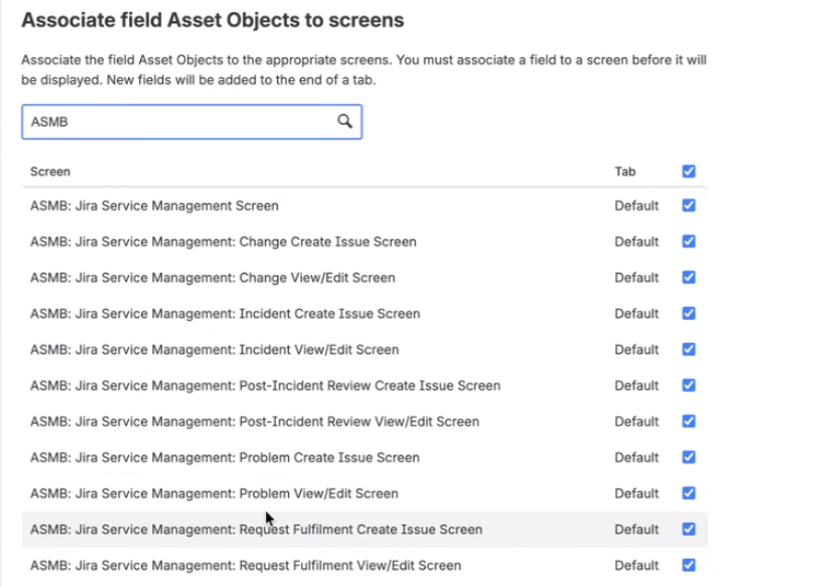

2. The custom object is linked to all the screens. So I believe we are okay there as well. Screenshot 2026-08-11 at 11.37.57 AM.png

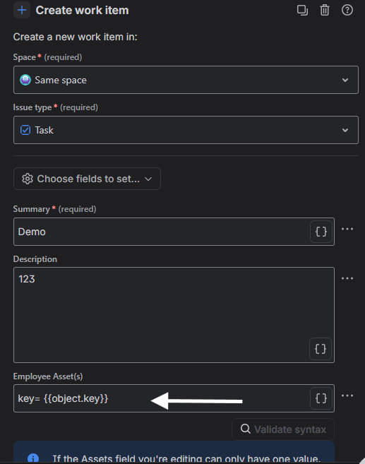

Since the JSON approach is giving you trouble, try setting the field directly from the UI field picker in the "Create issue" action:
  1. In your automation, go to the Create issue action
  2. Click Add a field and select Asset Objects
  3. In the value, type {{object.key}} directly — no quotes, no key= prefix
This avoids the array format issue entirely since Jira handles it natively. Give it a try and let us know! 👍
jiranewbi3
August 11, 2026
Hi Cristian, Unfortunately custom fields are not available to edited using the native system. We have to go through the json route.
