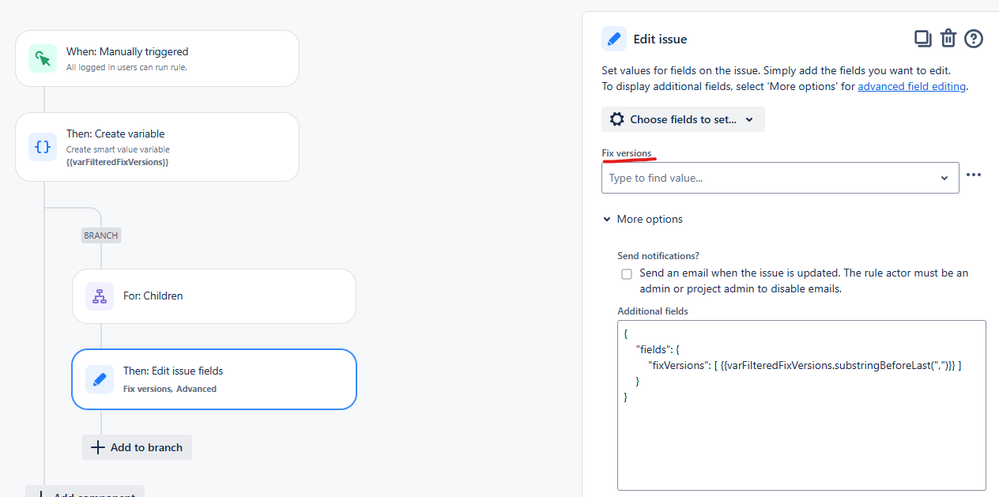

this is the automation that I wrote. In the edit action, assumint you selected fixVersion field, i see the use of json in Additional fields may not be correct.
Can you try with what i have in screenshot i.e. additional fields text box should look like
"fields": {
"fixVersions": [ {{varFilteredFixVersions.substringBeforeLast(",")}} ]

@Vishal Biyani leaving the field blank like that clears the value. We can't have both the field and the advanced edit.
Vishal Biyani
March 7, 2025
No. it doesn't. Otherwise, there is no purpose of Advanced fields.
You need to select the field as far as i know. Otherwise, automation will give the error that you are seeing.
Try it out with one test issue that you may have and see how it goes.
